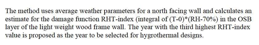

Re: ASHRAE RP-1325 - Year Selection
Yes: if you want to consider the 30-years worst case scenario, you select ASHRAE Year 1.
Please see attached screenshot from ASHRAE RP 1325 (Mr. Salonvaaras' research). His recommendation for standard dynamic moisture assessment is to use Year 3.
- Screen Shot 2017-08-17 at 09.06.54.png (33.31 KiB) Viewed 70080 times
