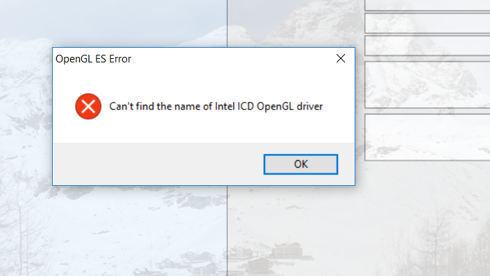

I have some problem with the program launch. I installed the latest version of wufi (6.1); when I try to launch the software an error message appears and the software crashes. It says: can't find the name of intel ICD openGL driver. I attach the screenshot.
I try to upgrade the drivers of the internal graphic card, but it does not work; also with the dedicated video card the same error appears.

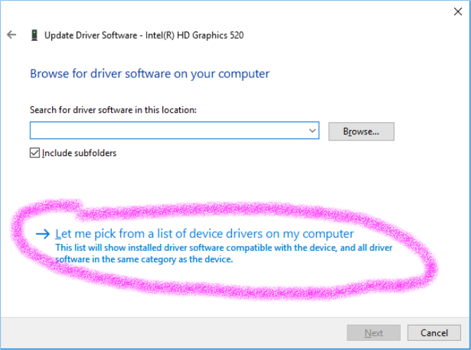

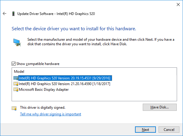

1) Don’t download any driver, but follow the intel guide as stated here: http://www.intel.com/content/www/us/en/ ... 05629.html
2) Instead of selecting the location, select “Let me pick…..” 3) Select an earlier installed version. In my case downgrade to the 9/29/16 version solved the problem
