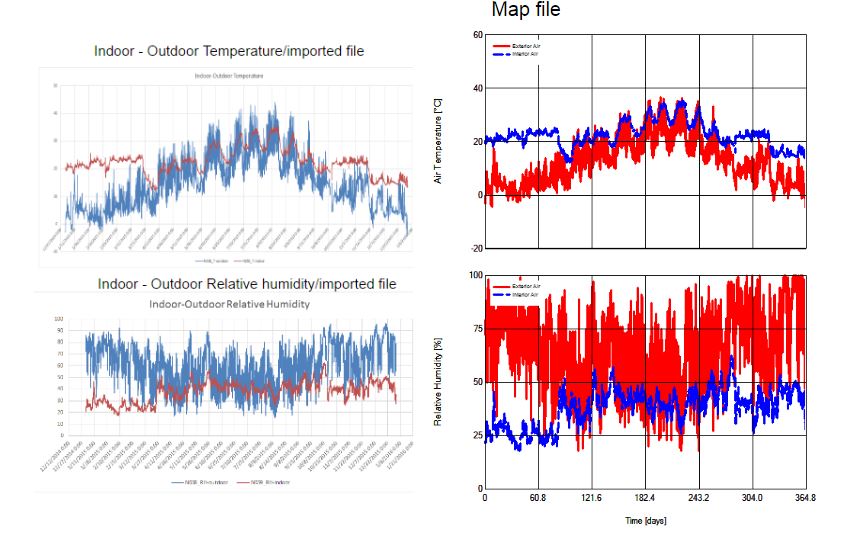

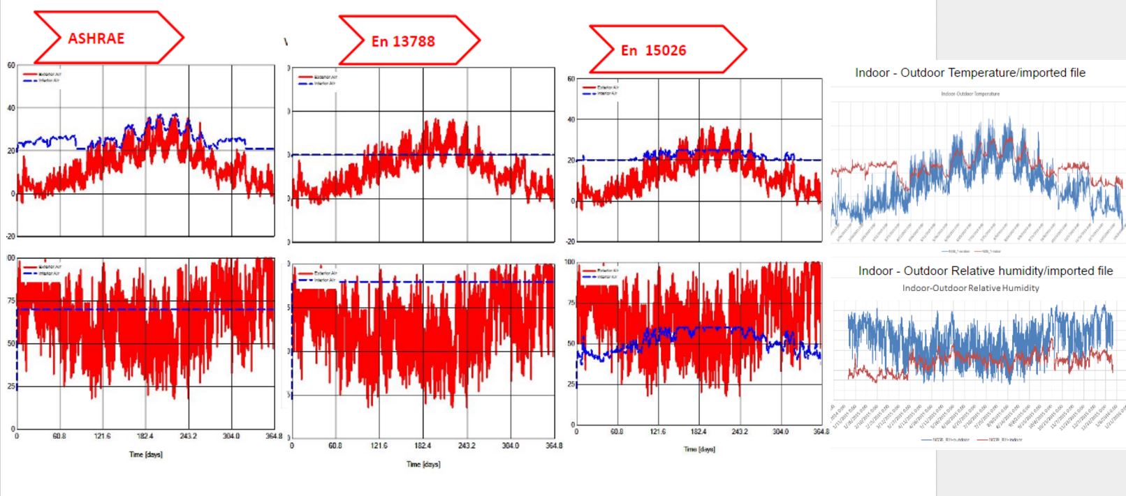

I have already created the indoor climate file in format of *.wac in wufi. I would like to use this file directly in wufi but when i put the tick of use left climate and i import indoor climate file , i should select again one of the standards of indoor climate.
Finally output result of simulation in indoor temperature and humidity graphs are very different whit my imported temperature and humidity that you can fine them in attachment file.
1. what is the problem?why the graphs are not similar to my imported file?
2.How can I use directly my indoor climate ?

After unselect "Use Left Climate", did you switch to "Map/File"?

No i did not switch to "Map/File" , it remained on perilously position and it is possible to choose other option.

Use "Map/File"

It worked .Thanks very very much for your help.
