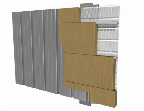

The insulation is some mineral wool (13cm) and behind it (internal side) there is a perforated (15% open) metallic sheet. A ventilated gap and a cladding are considered but in this case there is no air renewal in the ventilated gap.

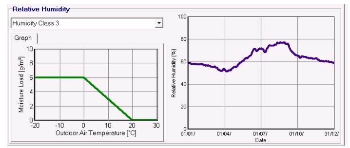

For the internal boundary condition, I chose the EN 13788 with a class 3. The HR for the internal air is the following. Note that it does not go over 65%.

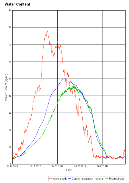

The simulation shows a very high water content in the mineral wool. It varies between a 3 kg/m3 to a 30-40 kg/m3. (The density of the mineral panel is 115kg/m3).
Also, it is shown clearly that the water content is higher on the inner side of the insulation as you can see in the graph.

- View of the wall
- schema_wall2.jpg (23.15 KiB) Viewed 11532 times
- Internal boundary condition
- internal_limit.jpg (38.26 KiB) Viewed 11532 times
- Water content in the insulation material. Different layers.
- WUFI_results_water_content2.png (37.15 KiB) Viewed 11532 times

what climate is on the exterior side? I guess it is an external climate with cold periods? In this case due to the non existing vcl there occurs condensation of the internal air in the insulation.

To answer : on the exterior side, we use the weather file of Grenoble. There is no rain absorption (due to the cladding).
Clearly there are condensations risks (even shown by Glaser method), but those high values were striking me.

Dear Antoine,
depending on the thickness you are assessing, the value seems not that high.
Please have a look on our tutorial "Condensation Assessment":
https://wufi.de/en/service/downloads#co ... assessment
Maybe try to compare your dew water amounts with them from glaser.
