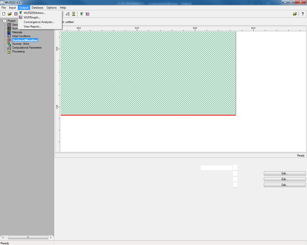

(main menu) tab "output" has no "asc-export" - see screenshot/attachment

- Posts: 353
Re: Indoor Surface Climate
OK, I didn't know it was WUFI 2D. Right mouse click on the graph should give you the export option. You just need to create temperature and R.H. graphs at the desired positions
No, it is not possible to export the boundary conditions with WUFI Graph at the moment. The blue boarder contains no data.
