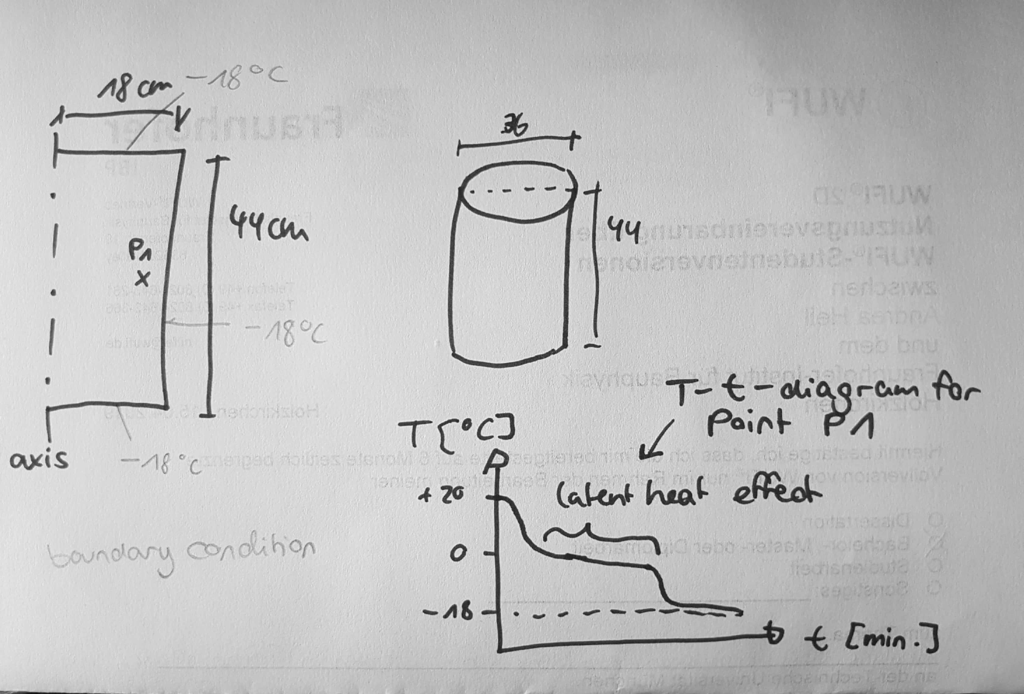

I want to do a transient thermal simulation of wet soil with phase change in a planting pot for my master's thesis. I want to analyse when the temperature in the pot falls below -5 °C which is critical for the roots during winter. I also want to test how much difference it makes to wrap the pot in different insulation material.
It would be crucial that the software considers the energy which is needed to freeze the water (latent heat) and the changing heat capacity and thermal conductivity when there is ice instead of water in the soil. And as I have a cylindric pot, I would like to use rotation symmetry. Furthermore, wet soils do not freeze immediately but have a temperature difference between solidus- and liquidustemperatur of about 2 Kelvin, so I need to be able to define solidus- and liquidustemperature for the material. Can WUFI 2D do that and how?
You find attached a picture of the principal setup.
For validation issues, I want to proof the simulation with an experiment by putting a pot into a refrigerator. Is it possible to set an initialisation temperature (+20 °C for the whole pot) and a constant outdoor temperature as boundary condition (-18 degrees) to be able to compare simulation with experiment? For me it looks like if it is only possible to let the calculation run with a whole year's climate data.
For the comparison I need to visualize the temperature over time for single points in the pot, where I have my temperature sensors.
This would be extremely simple in WUFI:
Set the initial temperature of the simulated "component" to +20°C.
Choose "sine curves" for the climatic conditions, select "user-defined" curves, set the amplitude of the temperature sine curve to zero and the mean value to -18°C. This will apply constant temperature conditions to the "component" surface. Then run the simulation.
No file with climate data is needed in this case (but could be used in case you want to use one).
After the calculation you can read out temperature curves for each grid cell of the computational grid.

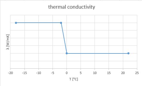

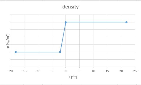

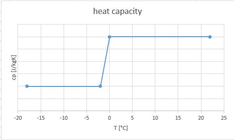

I would like to model the material in a simplified way with empirical values for the whole mixture soil-water-air. In WUFI it would be like a homogenous material. The latent heat would be taken into account according to the amount of water in the soil - see the formula attached. For this,I would need the possibility to define my own value for latent heat for a user-defined material.
The density, heat capacity and thermal conductivity would be modeled with empirical values like in the diagrams attached. In the literature I found -2°C as solidus temperature and 0°C as liquidus temperature because of the effects you mentioned.
Can I model the material like this in WUFI?
principle heat capacity.JPG (20.9 KiB) Viewed 48055 times
principle density.JPG (20.37 KiB) Viewed 48055 times
principle thermal conductivity.JPG (20.43 KiB) Viewed 48055 times

So you are not interested in any redistribution or evaporation of the water? If it's a purely thermal problem with effective thermal parameters for the "mixture" of soil and water, I think it should be possible. The key is WUFI's ability to use tabulated values for the specific enthalpy of the material, so that any desired heat capacity and latent heat can be modeled. See the "Gypsum Board; PCM" in the catalog "Wooden Materials; Boards" in the material database for an example.
(1)
The heat capacity at constant pressure \(c_p\) is the derivative of the specific enthalpy \(h\) of the material with respect to temperature:
\(c_p = \left( \frac{\partial h}{\partial T} \right)_{p = const}\)
So the heat capacity \(c_p\) at any temperature is simply the slope of the tabulated enthalpy curve at this temperature, and by tabulating an appropriate curve you can describe any desired temperature-dependent heat capacity by choosing the corresponding slope at each temperature.

WUFI can use a temperature-dependent thermal conductivity \(\lambda\). If you have measured values for the thermal conductivity of the "mixed material" soil + water, you can simply tabulate them.
