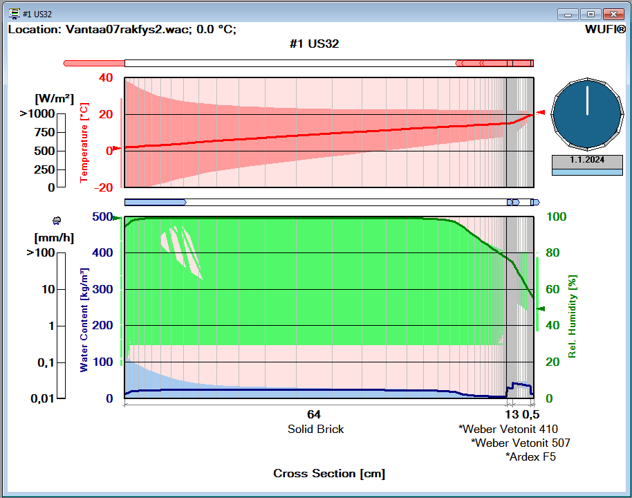

Hello!

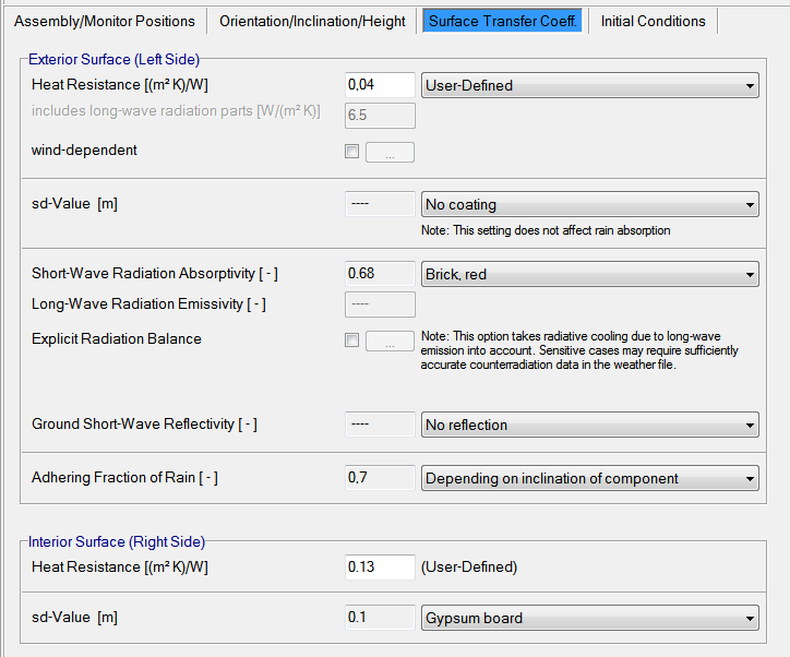

I'm modeling a massive masonry outside wall (600 mm, uncoated) and whenever I have driving rain on, the whole brick layer gets wet rather quickly. This is odd, since I've never encountered abnormally high moisture contents in massive masonry outside walls. Should I add a surface condition with a small Sd-value to the outside surface? Could I even switch off the driving rain altogether? The facade is an old bare brick wall so I think switching off driving rain might be a bit irresponsible...
I've encountered this problem with multiple different bricks (Fraunhofer: Solid brick masonry, Solid brick historical).
When I'm simulating massive masonry outside walls with rendering I have the same issue. The results seem more accurate when driving rain is switched off and when some Sd value is used in the outside surface.
I've enclosed some screenshots.

Could this effect be happening because the brick layer in the model is homogenous and the actual structure may have air pockets, vents, cracks etc. in the brick wall? Is there any good way of simulating them? Other than putting air layers in the model of course.

- Surface conditions.PNG (31.06 KiB) Viewed 7575 times
- Historical Brick.PNG (67.29 KiB) Viewed 7575 times

This is depending on the a-value of the different bricks. They usually take up the driving rain quite fast. The tricky thing is to estimate the amount of rain for your facade. In my eyes it is not unrealistic, that the wall gets wet fast if it takes up all the driving rain. Please also keep in mind, that your initial conditions may include lower moisture than in reality. In this case the construction sucks up quite fast to the equilibrium state. Walls which are exposed to rain all the time can have a high water content over the whole section.I'm modeling a massive masonry outside wall (600 mm, uncoated) and whenever I have driving rain on, the whole brick layer gets wet rather quickly. This is odd, since I've never encountered abnormally high moisture contents in massive masonry outside walls.
I would not do that. If you add a sd-value in the boundary condition, rain will be sucked in, but is drying out slower. If you place a membrane on you walls surface, no rain will be sucked in anymore. If the wall you are looking at, is exposed to rain, I would more try to adapt the rain coefficients.Should I add a surface condition with a small Sd-value to the outside surface? Could I even switch off the driving rain altogether? The facade is an old bare brick wall so I think switching off driving rain might be a bit irresponsible...
