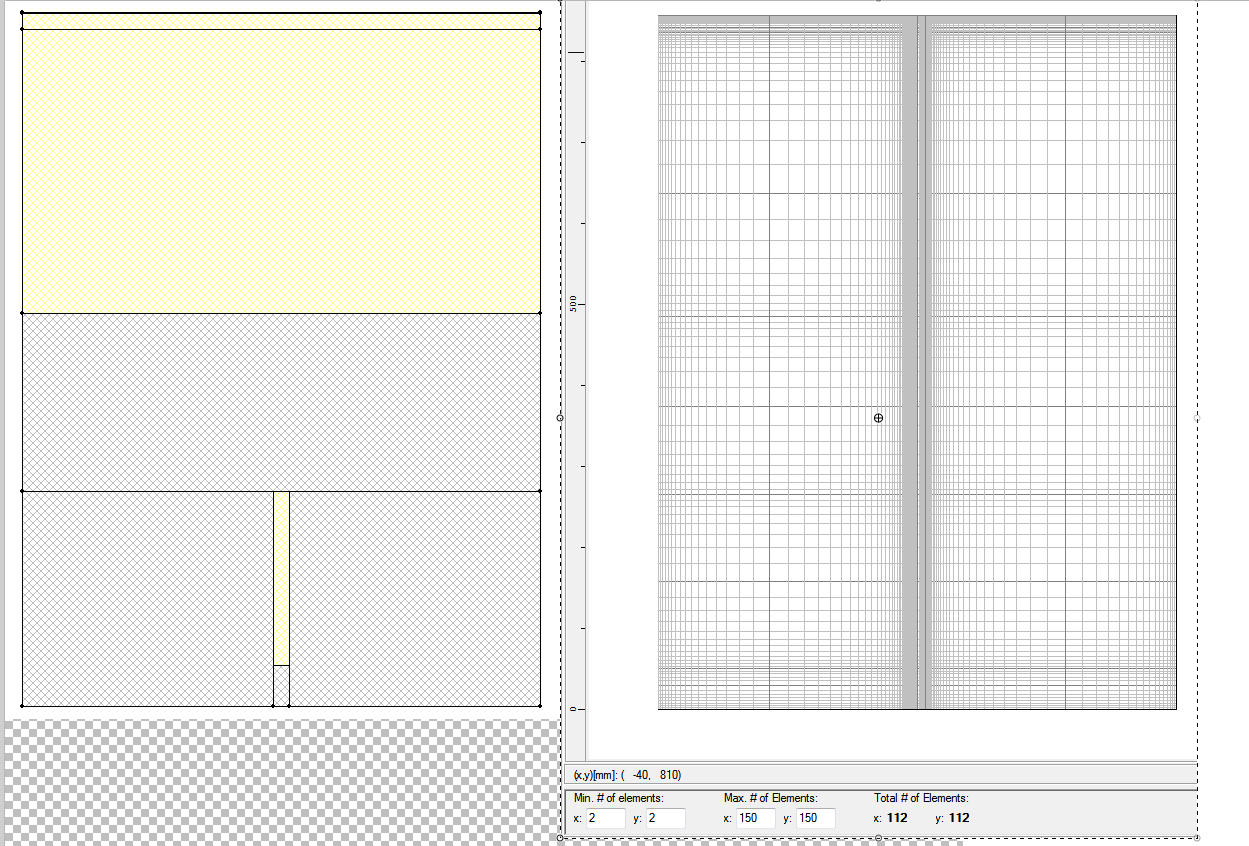

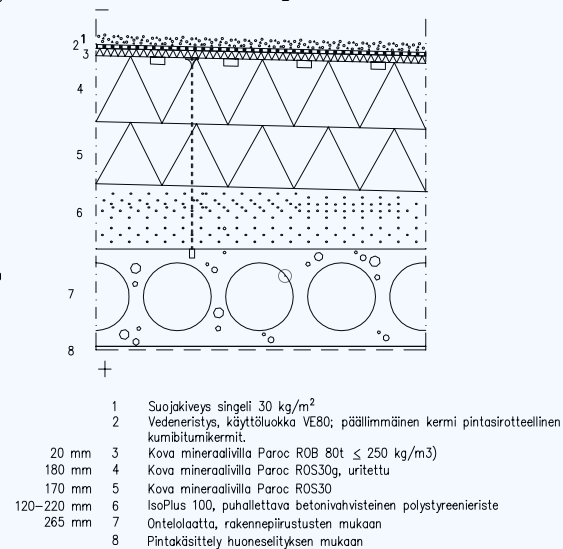

I've tried to simulate a flat roof structure (picture 1). The materials are (from bottom up) hollow core slab 265 mm, EPS-concrete pouring 120...220 mm, hard mineral wool 370 mm with ventilation cuts (15 mm x 25 mm), roofing felt (bitumen), gravel. Geometry and and grid are in picture 2.

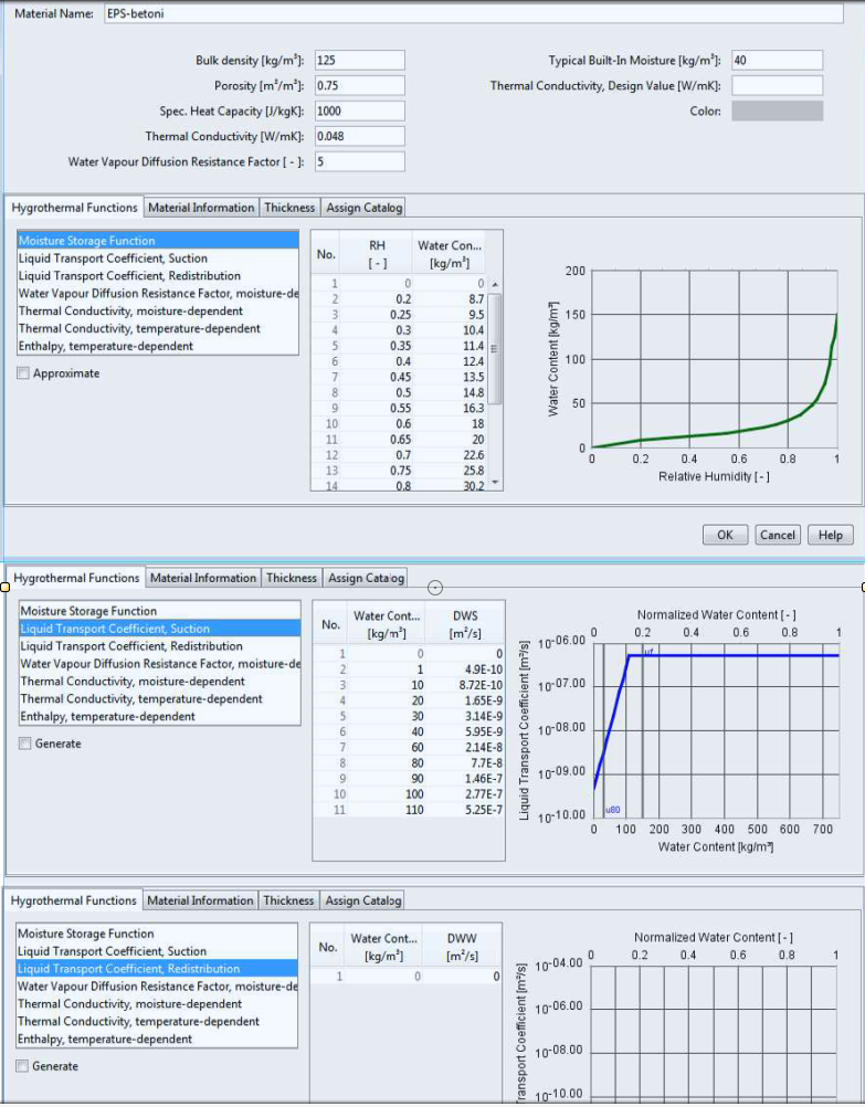

I also had to make a material file for the EPS-pouring (https://isoplus100.com/files/isoplus100_beps_wd_r.pdf) (Picture 4). I didn't find any values for DWW, so I left it blank.

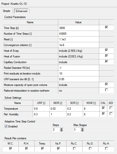

I've already tweaked the numerics a little bit (picture 5). I raised the NSW-value from 4 to 8. I also tried using NSW 1000, but quickly found out that it's reeeally slow. During different calculations a tried URF (phi) values 0,2; 0,3 and 0,4; but it didn't seem to have a noticeable effect. I also lowered the max iteration count from 1500 to 1100.

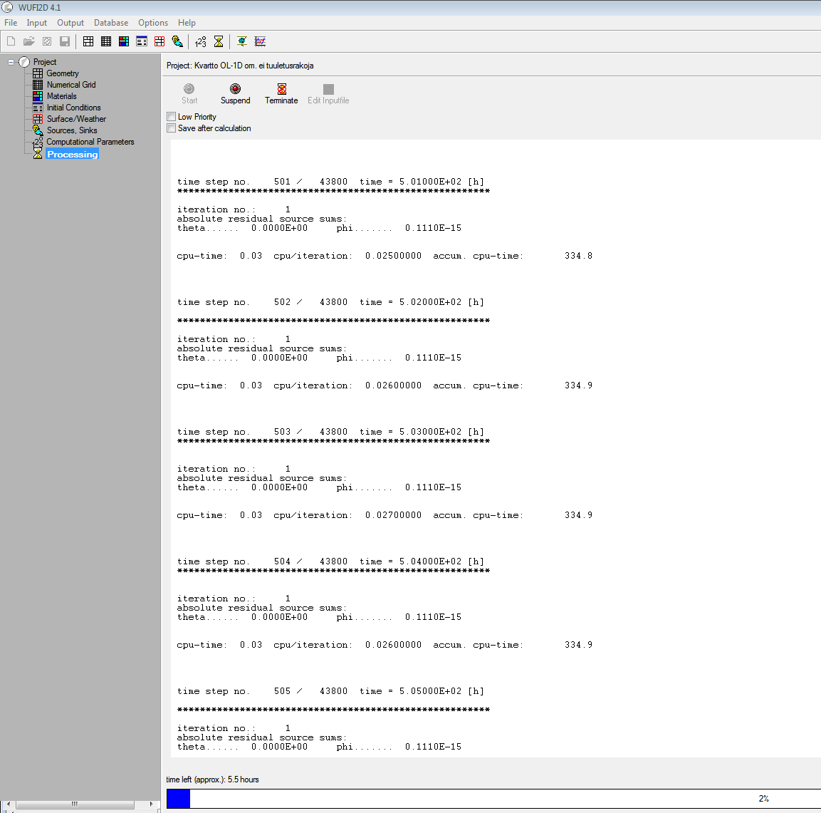

I'm having the following problems:

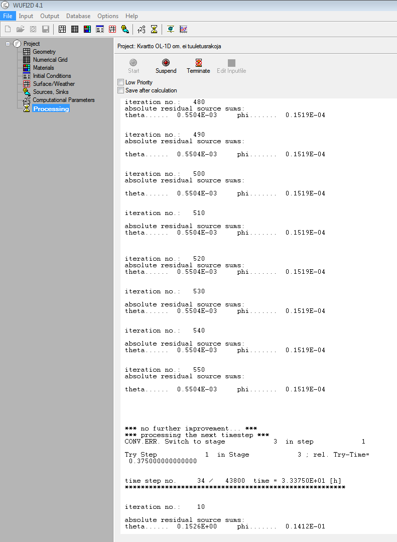

- I'm hitting an iterative wall occationally (picture 6). Residual phi seems nearly constant during iterations rather than converging or oscillating.

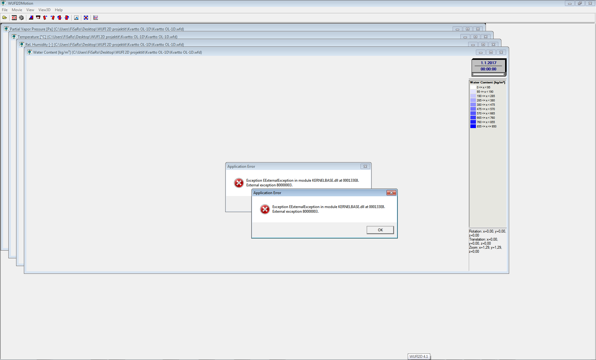

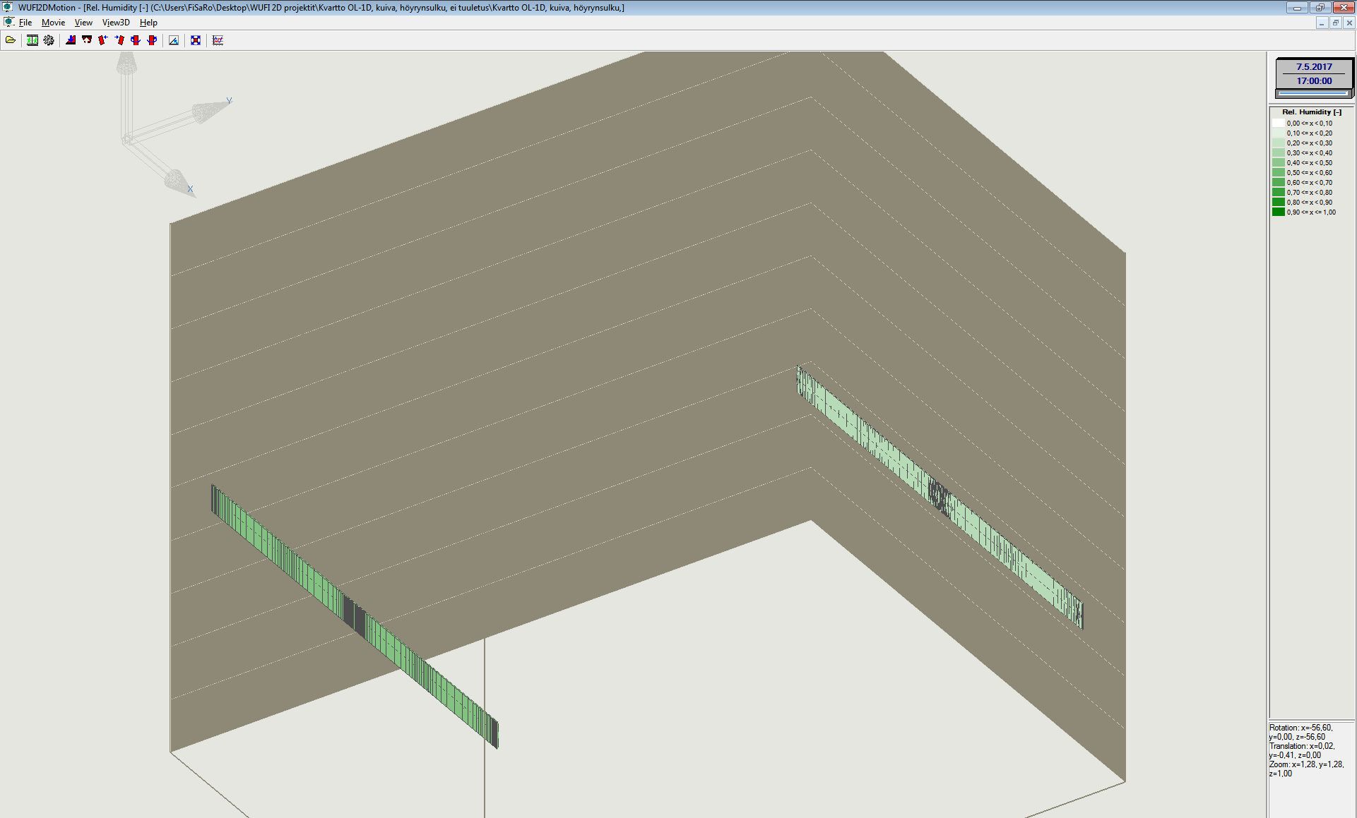

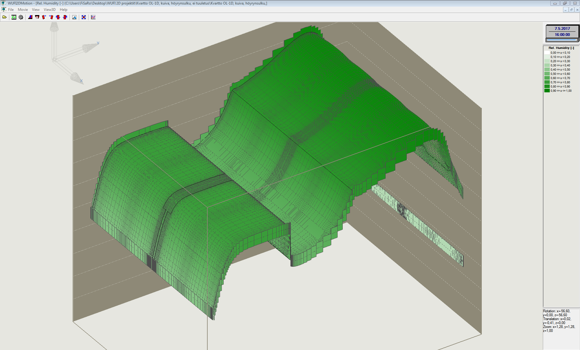

- At some point the iteration breaks down (picture 7). Every time step is solved instantly and the residuals are both 0. After this happens, the result file size is reduced significantly and it cannot be observed with Wufi Motion (picture 8).

Here is more of the pictures:
20190923 Kvartto YP iterative wall.PNG (38.47 KiB) Viewed 18315 times
Sami Roikonen
Posts: 22
Joined: Thu Jul 04, 2013 3:05 am -1100
Location: Finland
Re: Iteration breaks down and an abnormal result file is produced
Post by Sami Roikonen »
Here are the rest of the pictures.
20190923 Kvartto YP KernelbaseERROR.PNG (66.67 KiB) Viewed 18315 times
20190923 Kvartto YP computation mess.PNG (42.34 KiB) Viewed 18315 times

Hi Sami,
yes, that is proabably caused by supersaturation below the roofing felt.
Please try the following two things:
- In the enhanced solver settings switch on the "Rational interpolation of the sorption isotherm. This is new in WUFI 2D 4 an will interpolate the values from the sorption isotherm in a smoother way.
- Instead of the membrane on the top try to set an sd-value in the surface transfer coefficients in the boundary condition. The result is the same, but the calcualtion is much easier. We recommend to do that for tight membranes/foils on the outside.

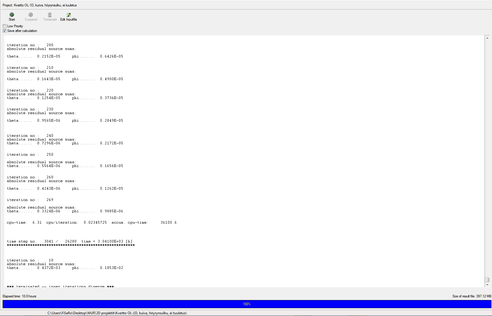

Hello again!
I'm having trouble again. I made a small modification to the roof structure by adding a vapour barrier on top of the hollow core slab. All the calculation options are as before, but for some reason, after a few time steps the iteration is halted "***TERMINATED - inner iterations diverge***". There was no problem without the vapour barrier.
I turned the rational interpolation of the sorption isotherm off and the calculation seemed to carry on just fine, but this morning the calculation was finished too early (time step 3041/26280).
This is perplexing, since I get this error regardless the initial moisture content in the structure. Whether I try to simulate wet concrete strucutures (initial RH 95 %) or dry (75 %) the result is the same. When the ration interpolation setting is turned on, the calculation halts almost immediately. When it's turned on, it seems to carry on fine for a while, but it'll ultimately halt.
The last time step is also weird in Wufimotion...
Can somebody help me with this?
20191016_Iteration diverges.PNG (35.59 KiB) Viewed 18257 times
20191016 last sane timestep.PNG (330.39 KiB) Viewed 18257 times
20191016 last timestep.PNG (75.84 KiB) Viewed 18257 times
Re: UPDATE! - Iteration breaks down and an abnormal result file is produced
Dear Sami,
your last picture of WUFI Motion is related to the convergence problems. It is showing only the boundary conditions, the other parts of the constructions seems not to contain any values.
Such behavior also may be related to a special combination of materials. Please try, if you can calculate this using other materials. Start replacing the mineral wool, then try the mineral materials.
