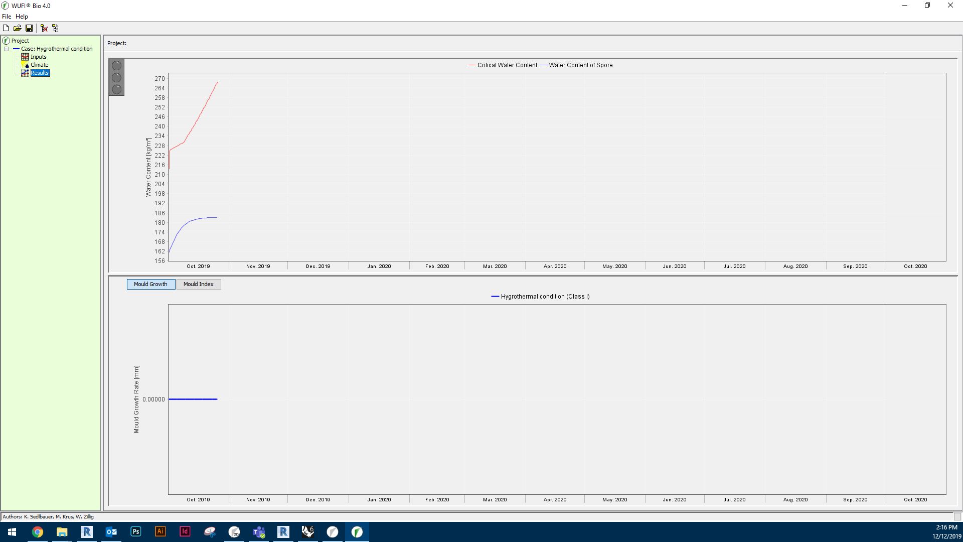

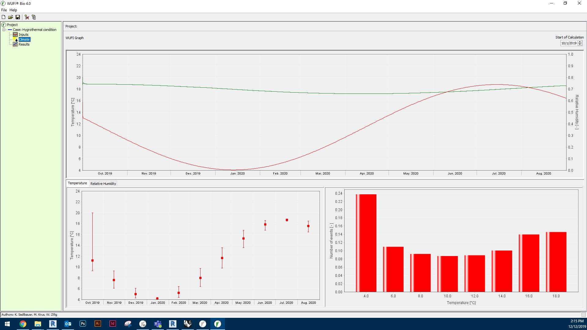

I have an update. I tried a very simple analysis to troubleshoot WUFI Bio. I am just using the sine graph for climate. In WUFI Bio I can tell it's reading the full climate year. (First Image) When I look at the results, the curves only exist for the first month, which is why the traffic light is confused. Any ideas why this would happen?
