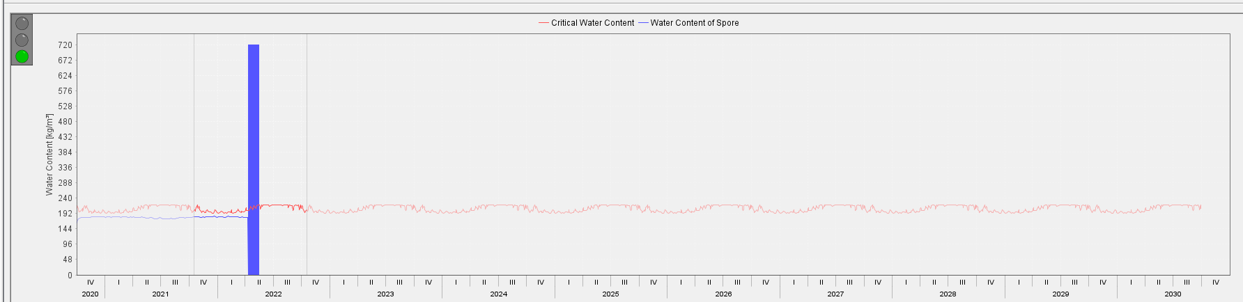

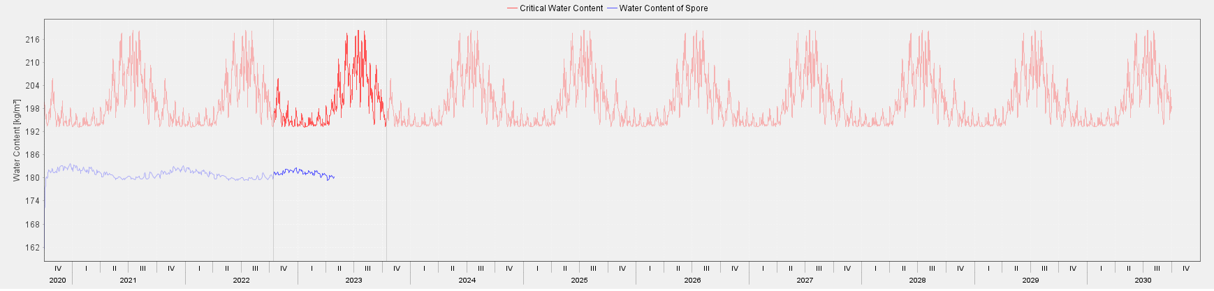

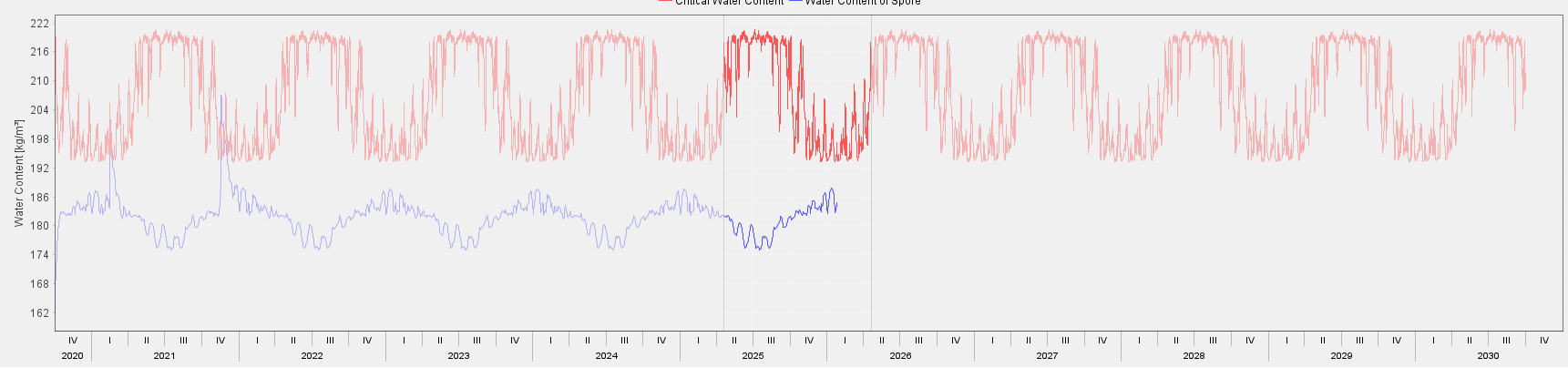

Hi everyone,
I'm currently trying to model a wall build -up in different climats. However, the output graph is confusing me: the water content of pore graph seems to stop after a few years? Not droppping to zero, just stopping - see screenshots. Is that normal? Does that just mean that the spore are dry and/or they remain under the critical water content so the software assumes it doesn't need to go further? Or is there some kind of glitch in the model?
water content 3.PNG (74.69 KiB) Viewed 58817 times
water content 2.PNG (85.95 KiB) Viewed 58817 times
water content 1.PNG (42.32 KiB) Viewed 58817 times

This may be corrected in the latest version. Please check and come back to us, if issue still appears.
