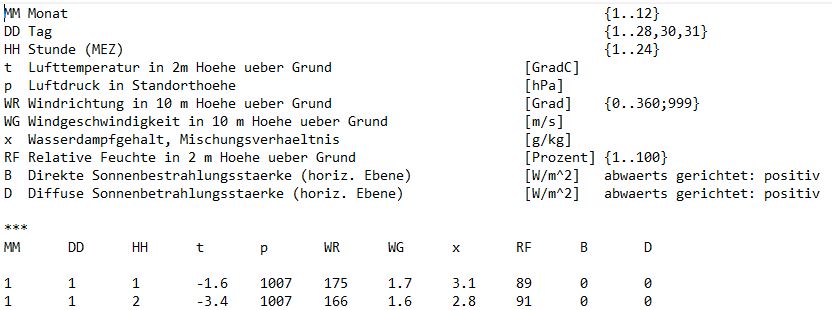

im currently experiencing crashes when I try to import ".dat" files as they are provided by the DWD. When I browse the file and then manually describe longtitude, latitude, height and UTC-Time Zone the programm simply shuts down. The data structure at this point looked like displayed in attachment 1.

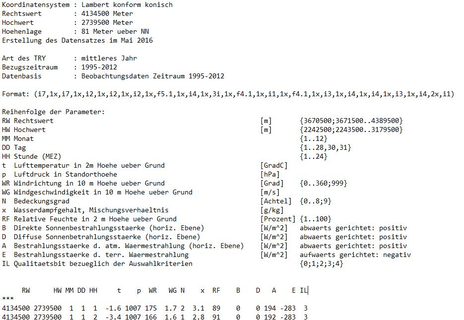

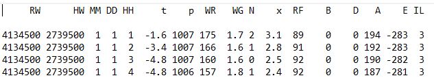

I wondered if it might have a problem with certain information, so I reduced the file to only necessary data in 2 steps- displayed in attachment 2&3.
The programm did not crash, instead delivered an error message "atmosspheric pressure outer range 500hPa-1500 hPa)", which is not true for the file and led me to the conclusion that I dont know how the structure of the file is supposed to be.

- Step 2 simplification
- DWD_minimal.JPG (29.91 KiB) Viewed 55495 times
- Step 1 simplification
- DWD_mediocre.JPG (59.33 KiB) Viewed 55495 times
- origninal .dat formate
- DWD_original.JPG (126.62 KiB) Viewed 55495 times
