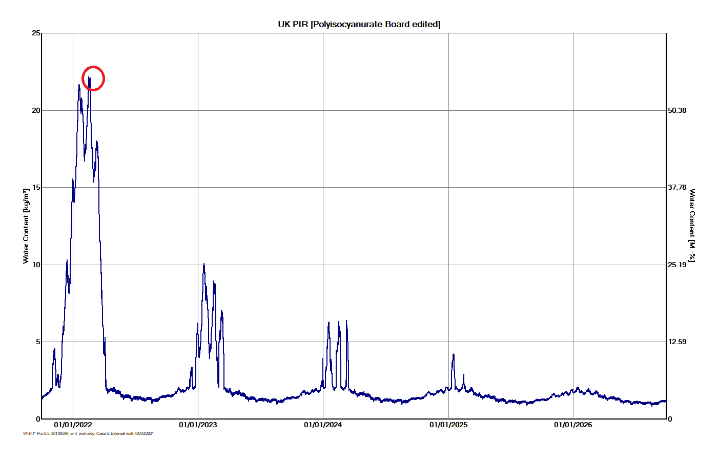

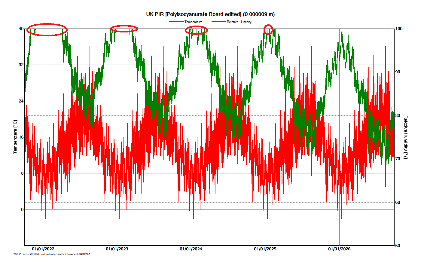

I’ve created a 1mm PIR layer next to the outer aluminium foil layer to assess the condensation risk.
The relative humidity graph of the PIR layer against the outer aluminium foil shows periods of 100% RH which I assume is liquid water i.e. condensate forming:
The water content in the 1mm of PIR insulation next to the outer aluminium foil layer is at a maximum of 22.9 kg/m3 in year 1.
22.9 kg/m3 is in excess of 2.15 kg/m3 value from the moisture storage function but less than the 60kg/m3 European PU maximum moisture absorption.

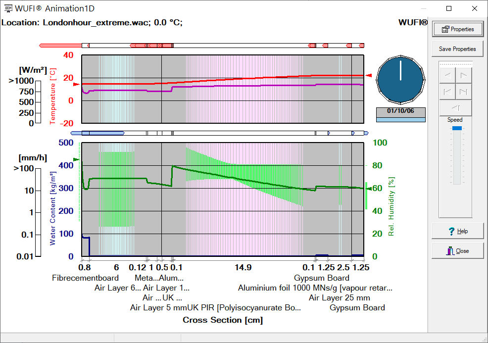

4. Is there a way to analysis the WUFI data to understand why and how the water content decreases with time? In other words to answer the question where does the condensate go? Or how does the condensate decrease over time?
