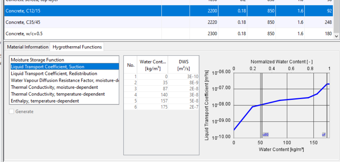

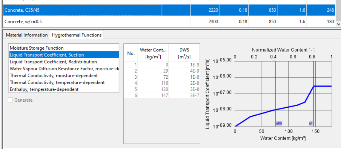

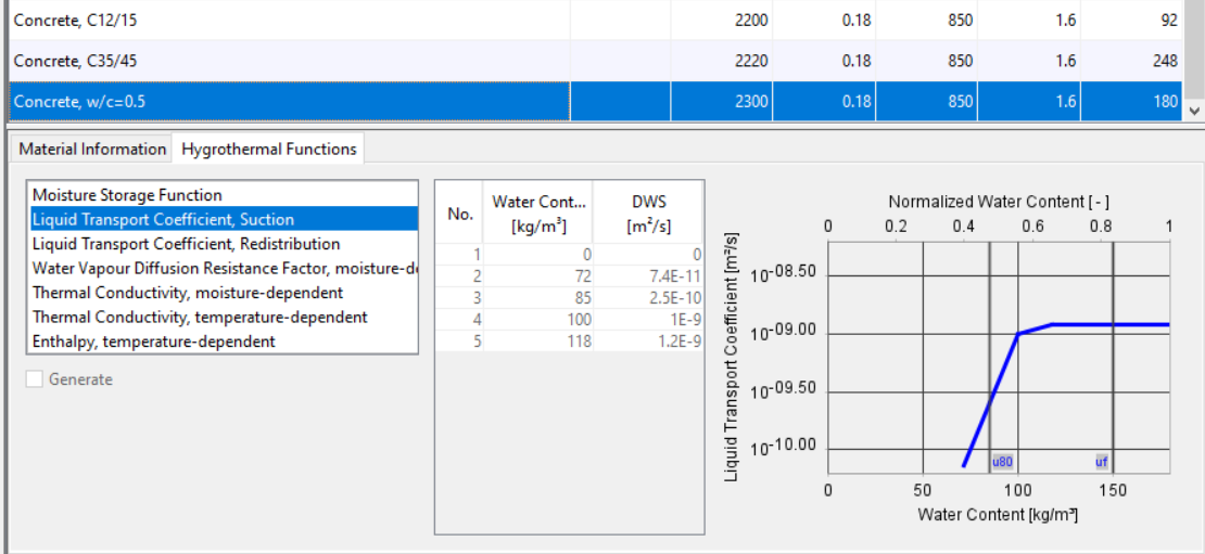

Hi everyone,
Does any one knows why liquid transport coefficient property is so different between "concrete C35/45" (or C12/15) and "concrete w/c=0.5" ? The values for "C35/45" and "C12/15" are relatively close but both are up to 200 times higher then "w/c=0.5" value.
Thanks for your help.
