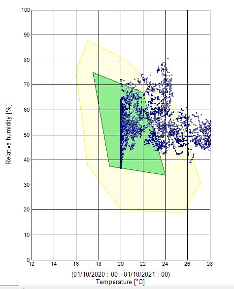

Dear WUFI team,
I am doing some calculations on WUFI PLUS, I have some questions about the results graphs.
On the thermal comfort graphs, I see that there are two colored diamonds.
What do they correspond to? Yellow for the EN15251 standard? Green for ASHRAE 55-2004? Also, we would like to determine the number of points that are outside these diamonds, is it possible to find this value? How else can it be calculated?

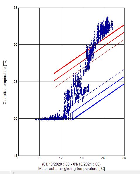

Same question for the graph of image 2, can we have the number of points outside the comfort zone?

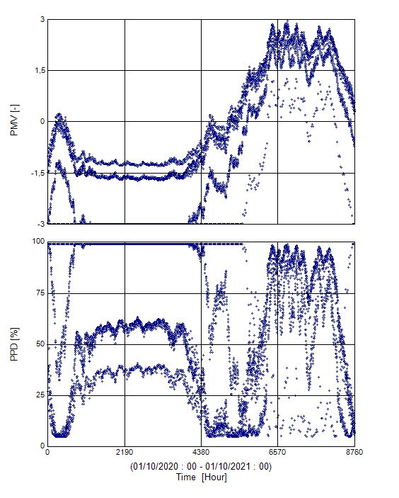

For the PMV and PPD graphs, my results seem inconsistent, as you can see on the image below. Do you know why the curves appear to be several?
When I export the PMV data, I have one value per hourly time step, why does the graph seem to show several?
