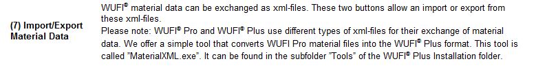

I found in WUFI Manual an answer to my question:
"[...]Please note: WUFI® Pro and WUFI® Plus use different types of xml-files for their exchange of material data. We offer a simple tool that converts WUFI Pro material files into the WUFI® Plus format. This tool is called ”MaterialXML.exe”. It can be found in the subfolder ”Tools” of the WUFI® Plus Installation folder.[...]".
So I tried to open the exe.File (WUFI-DB.exe) as adviced in the manual but it desn't work and this message appears:
"unauthorized call".
Could you help me please?
