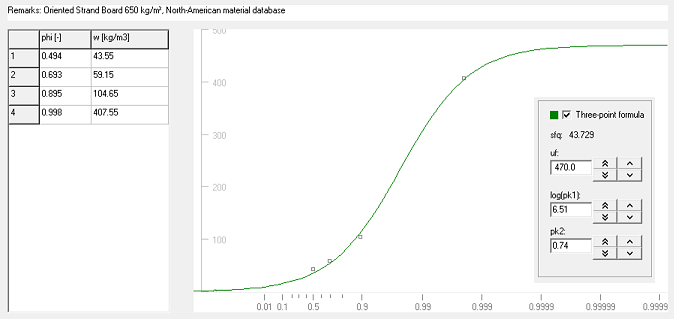

It's called "3-point formula" in WUFI to distinguish it from the "two-point" formula which WUFI uses for approximating the moisture storage function if two points (usually u80 and uf) are given. The 3-point formula is more flexible, but it needs three points as input since there are three free parameters (\(u_f\), \(pk1\), \(pk2\)). We usually choose the points u(RH=80%), u(RH=95 %) and u_f, but other choices are possible as well. If more than three points of the moisture storage function are available we usually fit the curve to all of them in a least-squares fit:
Three-point-formula _OSB 650 _ uf = 470 kgm3 _ B.png (28.26 KiB) Viewed 56754 times
