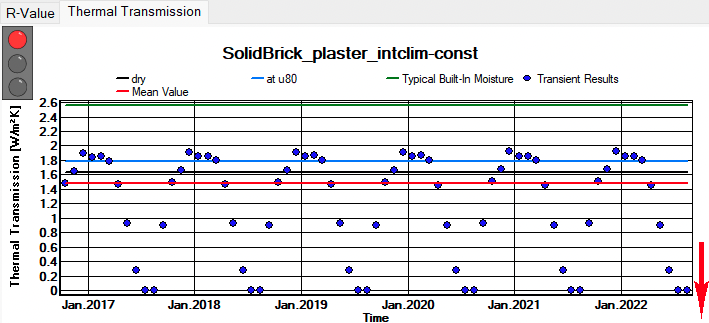

I am simulating the simplest of structures, a solid (Fraunhofer) brick with interior plaster, and I am looking at the transient U values as calculated by the thermal transmission module. For 2 months out of 12, specifically July and August, the U values are shown as equal to zero - see attachment. How can this be possible? And how can it be that the corresponding R values (also attached) are not the reciprocal of the U values?

these data are results of an evaluation of the transient heat flows through the component, and under these conditions the relationship between R- value and U-value is more complex than for the steady-state conditions which are usually considered.
The transient R- and U-values may even become zero or negative. The help file for the postprocessor says:
The red arrow in your second screenshot shows that this has happended here.The post-processor is intended to assess heat losses. Under warm outdoor conditions, heat may flow into the building, resulting in negative R- and U-values. These negative values are set to zero, a red arrow at the side of the diagram alerts the user to this.

Thanks, Thomas, your explanation makes sense, although I can't imagine why WUFI would artificially U-values to zero if negative and not keep the absolute value, which would carry physical meaning.

Hi Apostolos,aease wrote: Mon Oct 10, 2022 12:19 am -1100 although I can't imagine why WUFI would artificially U-values to zero if negative and not keep the absolute value, which would carry physical meaning.
that's because the U-values are usually used as a measure for the transmission heat loss of a building. Negative heat losses should be distinguished from positive heat losses, but they are of no real use to you because they do not compensate the losses that have already occurred. Beyond that it is somewhat arbitrary, yes.
