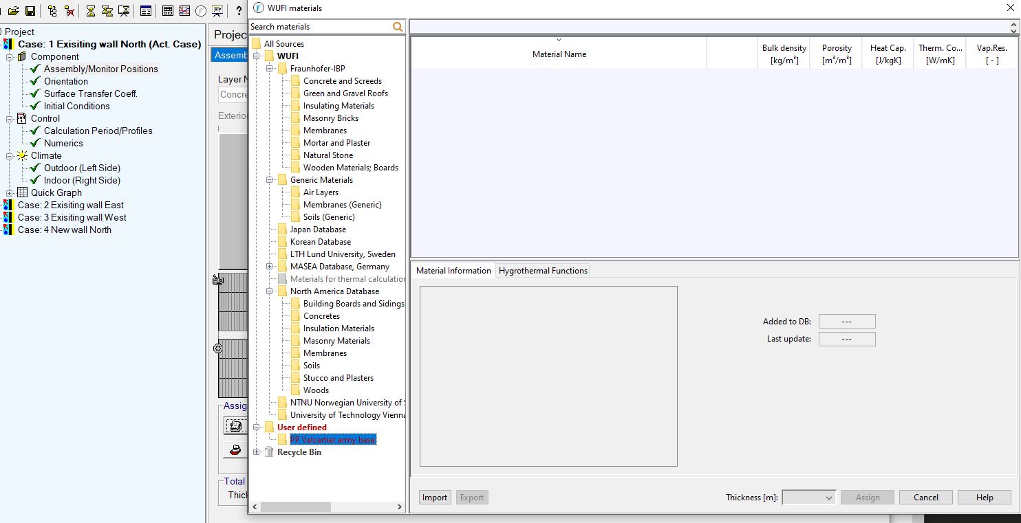

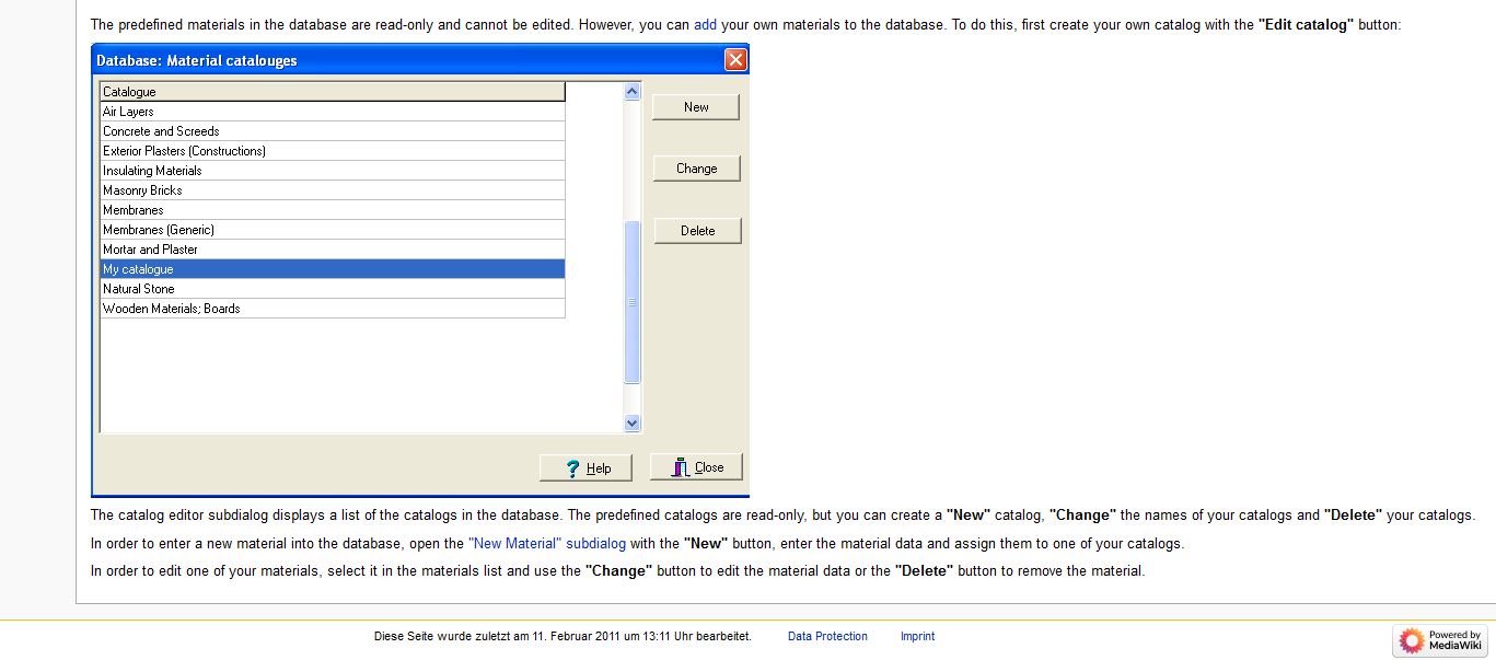

I know this is very basic but I cant seem to add new materials to my catalogue, I can add a catalogue to my user data base by right clicking. I find the resources that say hit the "new" button, but in my material data base window, i don't have that anywhere. I know I am missing something very simple. Do I just copy a material over to my database and delete all its inputs to add my own?
basic fucntion materials
- 2.JPG (136.14 KiB) Viewed 56013 times
- 1.JPG (108.09 KiB) Viewed 56013 times

Hi Foti,
there where some changes in the WUFI 6 database. "New" does not exist any longer, but do a right-click on an existing material. There you will find "New material" which creates a new material based on the selected existing one.
