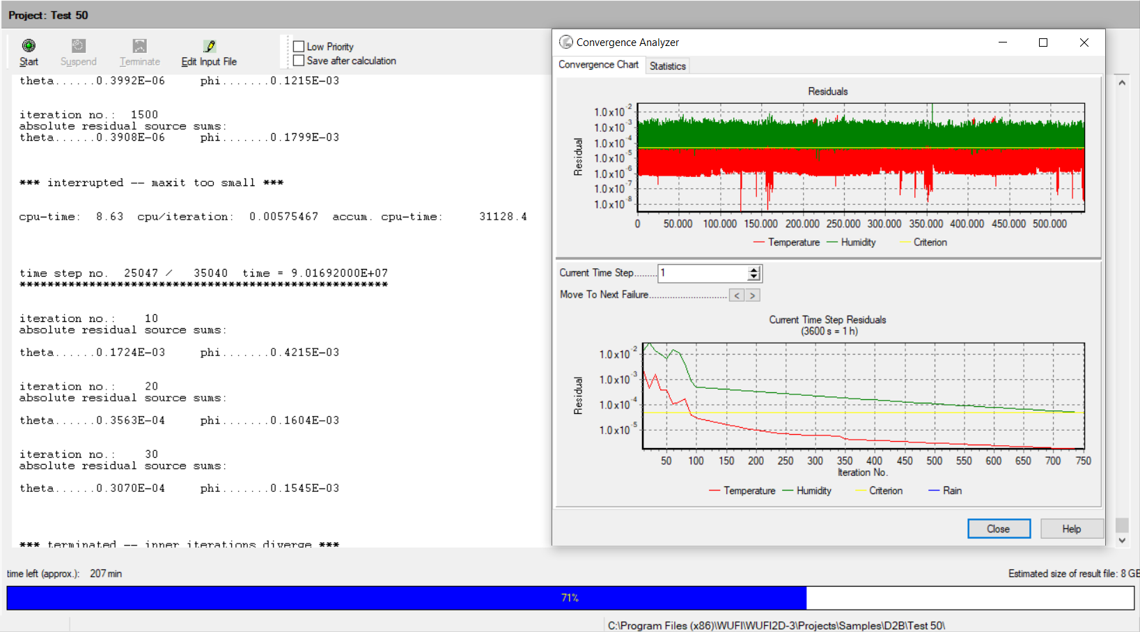

Indeed, it is the same problem that I have. But the strange thing is that I received the file from a former colleague where the simulation was running correctly with the same grid.
Could it be that the simulation is computer dependent? (related to computer memory or something like that?)
I have tried it again with maximum 'Increased Accuracy' (5E-5) and maximum 'Adapted Convergence' (1500). The calculation goes a little further, but still stops before the end (see attachment).
Thank you for your reply.

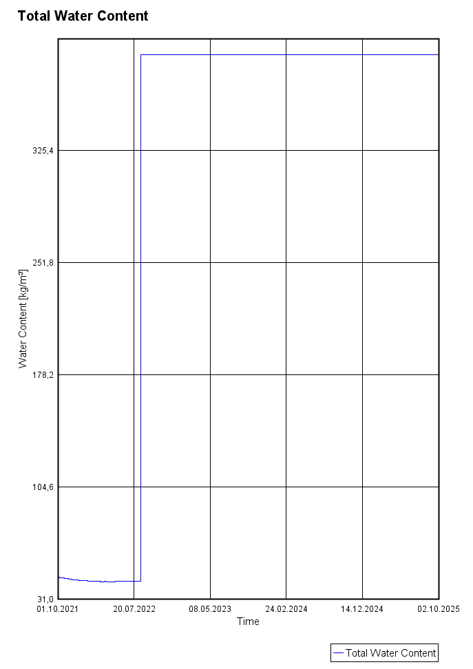

At the time step the calculation break down, does there a peak in water content appear somewhere in the construction?
the result of WUFI 2D should not depend on the computer. If your colleague had an older version of WUFI 2D, the grid may be have changed during loading. Did you change anything else but the grid? Because that also can be affected by eg. different boundary conditions, materials....

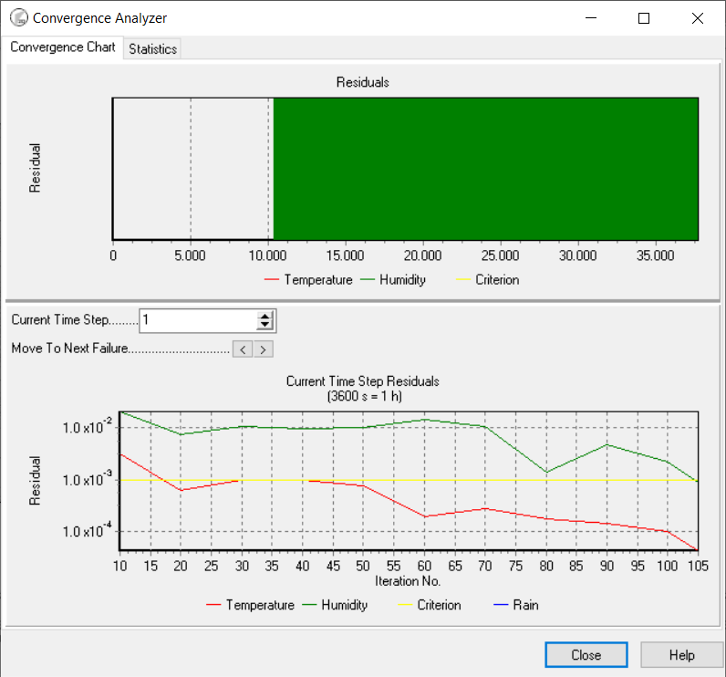

Indeed, there is a very high water content peak (up to +/- 400 kg/m³!), but it appears in the whole insulation components, not only in a specific area.
When I refine the grid, the calculation runs to the end but I still get strange results with a very high water content peak. See attachments.
When I make the grid even finer, then the calculation doesn't run to the end again.
No, I didn't change anything from the file that I received.
