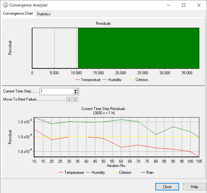

I have tried it again with maximum 'Increased Accuracy' (5E-5) and maximum 'Adapted Convergence' (1500). The calculation goes a little further, but still stops before the end (see attachment).

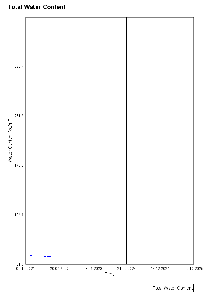

the result of WUFI 2D should not depend on the computer. If your colleague had an older version of WUFI 2D, the grid may be have changed during loading. Did you change anything else but the grid? Because that also can be affected by eg. different boundary conditions, materials....
At the time step the calculation break down, does there a peak in water content appear somewhere in the construction?

Indeed, there is a very high water content peak (up to +/- 400 kg/m³!), but it appears in the whole insulation components, not only in a specific area.
When I refine the grid, the calculation runs to the end but I still get strange results with a very high water content peak. See attachments.
When I make the grid even finer, then the calculation doesn't run to the end again.

This problem is somehow related to convergence problems. If reducing the grid does not help, maybe change in material, sources if included, boundary conditions or also simplifying the construction may. If the condensation occurs in air layers, splitting may help (see here: viewtopic.php?f=32&t=1777&p=5226#p5226). Without knowing what you like to simulate, it is not possible to give more specific tips.
