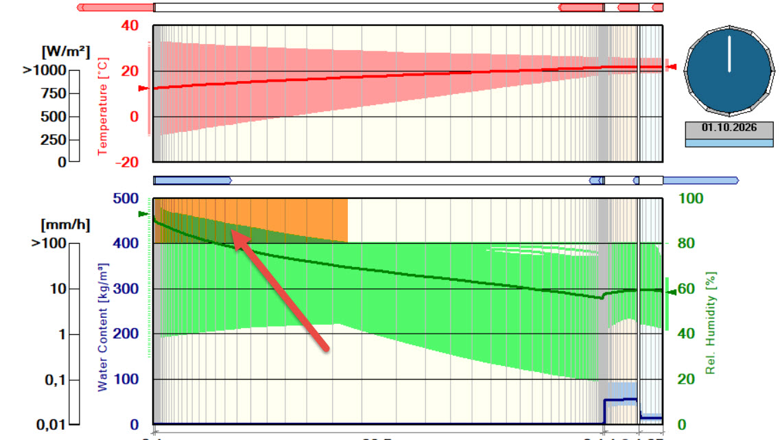

is there any way of knowing how many days during the year the humidity in the construction is above 80%?

Dear Karel,
that is not possible in the moment. Only way would be to export the courses as ascii and then evaluate that using excel or similar tools.
I will put that on our list for future development.

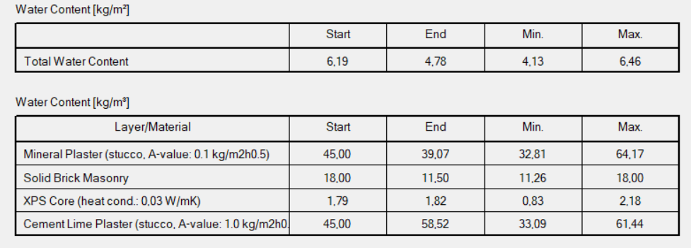

I want to ask a similar question about material water content and degradation of material level...when look at the picture after analyses i can see that XPS material deposit the water but in fact is this material have no pore...so how can it is possible or i think wrong ?
thank you
thank you
- water content_xpsli kesit.png (69.97 KiB) Viewed 67937 times
Re: High humidity in the construction
Thats not completely right. XPS has a lot of pores, but they are closed and thus the are nearly filled with water. So there can be a small water uptake depending on the boundary situation. As there is an internal moisture storage function used, the water uptake can be overestimated for this material. Please note that the XPS core should be used with the XPS Surface Skin on boths sides, as the core is more permeable than the skin. For more information see the materials info text.

yes, now i reconstruct my wall section. And also if i add moisture source, would i add the 5mm of the layer of XPS core or XPS skin layer ? Another question is about assessment of the material degradations...Now, i assess the insulation materails about thermal conductvity function as means of rising the water content...as recommended in the guideline but for example cement lime plaster and other materails how can i assess about degradation ? Is it right compare upper moisture function (for example water content related to above %80 relative humidity) Is is right or not ?
Thank you.
Thank you.
The moisture source should be placed at the position, where you assume the water to intrude. If this for example my intrude in gaps in window sills, then enter it at this position. As no water can flow through the XPS, the source should not placed in there. In this case I would place it in the cement lime plaster or the outer layer of the masonry.
Regarding the evaluation of the mineral layers: As they are usually not harmed by moisture you may evaluate the frost risk. See here for evaluation of materials: viewtopic.php?f=8&t=1623
