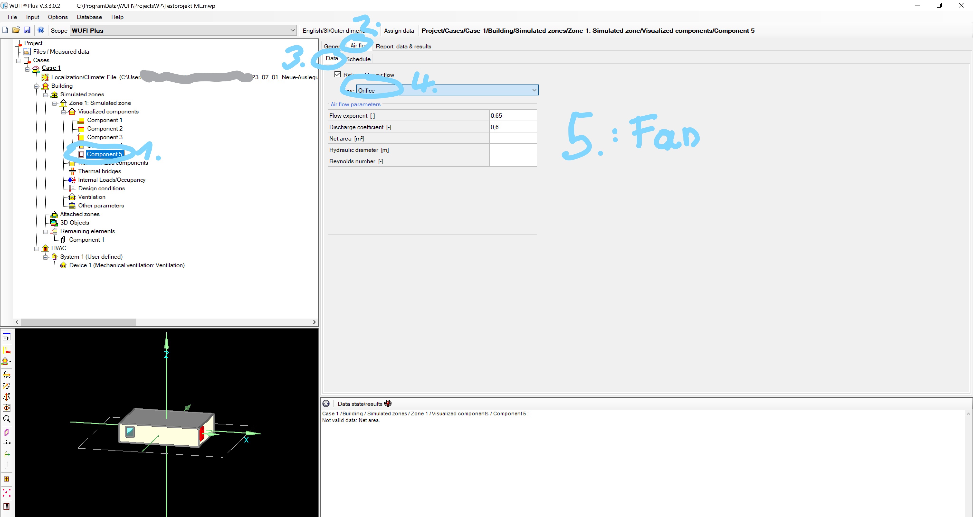

Dear WUFI-staff, dear forum users!
When using the Air Flow Model in WUFI Plus, version 3.3.0.2, the program crashes on multiple occasions. This has been tested on several devices (a Windows 10 and 11 PC), trying it out on multiple WUFI Projects.
When a hole in the wall is created, it is set to be an opening. The opening is then set to be a fan (see screenshot). When selecting the fan, the program immediately crashes.
In the numerics section, when clicking "Pressurization Test", the program immediately crashes.
Both these features play a crucial role in the success of my research work, so I'd be happy to receive help.
I wonder how to solve this problem. Are these issues known? Are different versions or licenses available that these features do work with?
D. :)
Fan selection crash.jpg (670.33 KiB) Viewed 52564 times
djj
Joined: Thu Jul 13, 2023 7:40 am -1100
Re: WUFI Air Flow Model: Fan selection and Pressurization Test lead to program crash
Post by djj »
A working version has been found in WUFI Plus 3.2.0.1
