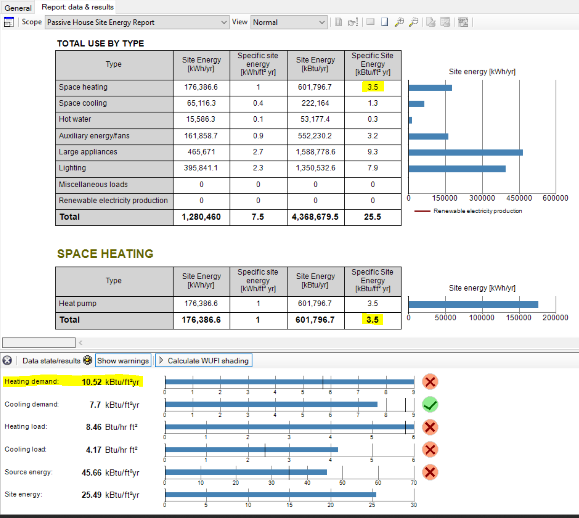

I'm noticing a major discrepancy between the Heating demand in the PH Certification results menu, versus the heating demand shown in the Site Energy Report end use breakdown. What could be causing this? Please see the attached screenshot.
Heating EUI.PNG (798.5 KiB) Viewed 55524 times

I guess you are using a heat pump?
You can try to set the Total system performnace ratio of heat generator for your heating device to 1.0 insted of 0,33
