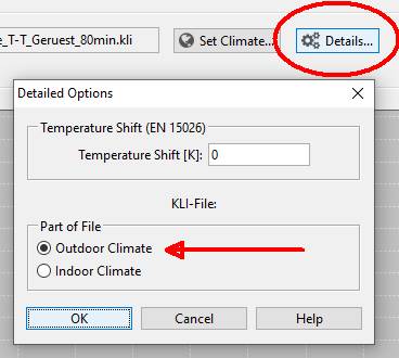

Hello! I have already inputted the climate file of KLI into WUFI, and I have filled in the rainfall data, but at the beginning of the simulation run, it still prompts me that the rainfall input is empty. What is the matter? The format I filled in is not incorrect. Could it be that the rainfall in a file of kli type will not be read? Can I use WAC files to read the values of rainfall and wind speed?

for the kli-File the rain has to be entered as measured rain. To use the rain from a kli in WUFI you have to set the file to outdoor side.
Select outdoor part for kli
The use of a wac file is also possible, here you need to input data for rain, wind speed and direction.
