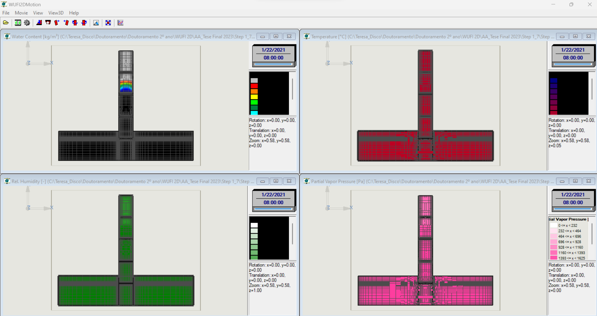

I'd like to know how to fix a problem I've experienced using WUFI 2D Motion. I often use this tool to view cross-sectional profiles of various parameters in my construction element. I've run many simulations without any problems! But in the meantime, everything appears black in the subtitles area for some parameters. Even result files with no problems now appear like this (see picture below).
Can you tell me how to solve this problem?
Thank you in advance!
Teresa Stingl Freitas
P.S.: the version of WUFI 2D I'M USING IS 4.3
Example
Example
WUFI 2DMOTION.png (336.6 KiB) Viewed 59671 times

Hi Teresa,
In WUFI2DMotion you can click on the title (the row above the colored boxes) and change the background color in the chart and legend.

Thank you very much for your quick reply!
I didn't know it was possible to change the background colour! The values and colours of the subtitles yes, but the background I didn't know was possible!
Problem solved!
Thanks so much!!!
