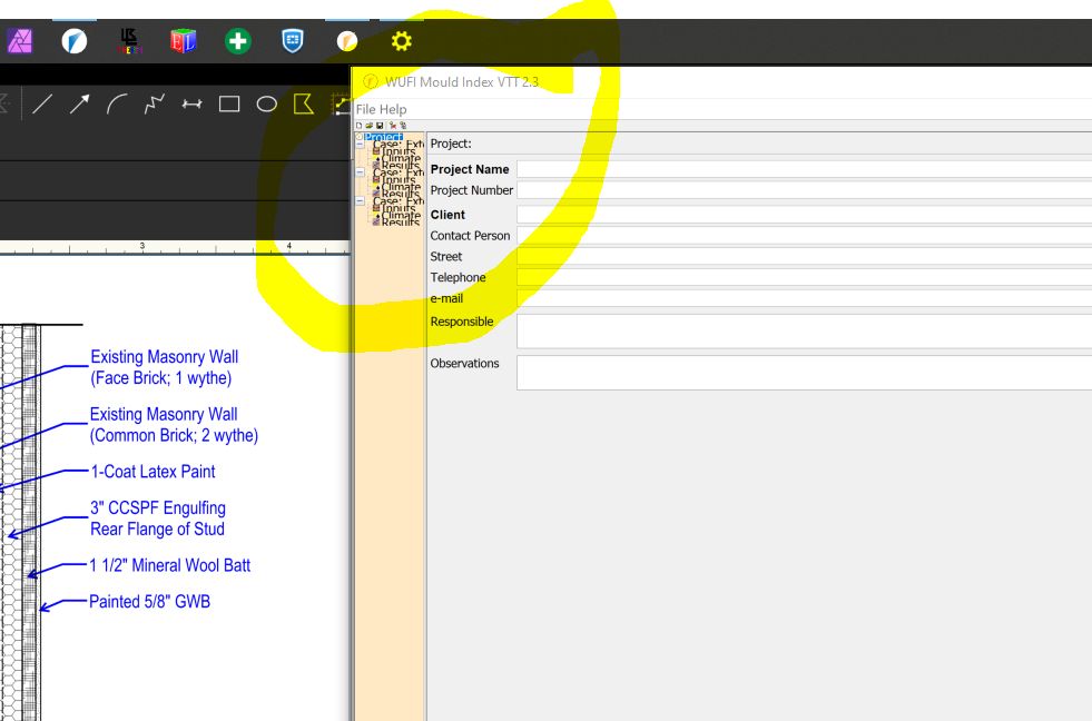

On the post-processor modules, e.g. VTT, BIO, COR, the text is very small and difficult to read. Has anyone else experienced this problem and have an answer?
Very small text.jpg (60.04 KiB) Viewed 99715 times

This is usually caused by a high resolution display. To fix this problem, run the file C:\Program Files\WUFI\jre\HiDPI_add.reg and restart the post-processor to see if it works.
