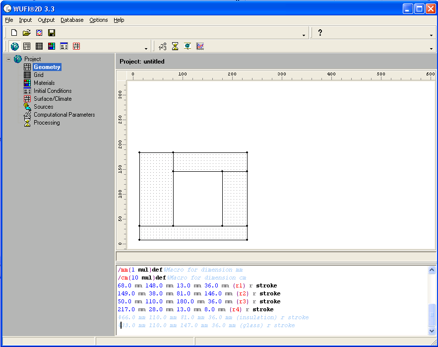

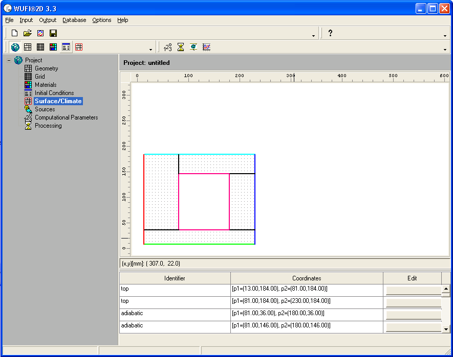

You could remove the glass and insulation (comment the definition using "%"), set the arising "new" boundaries to be adiabatic and compare the results to the previous one.
The results are not the same of course because of the missing heat transport through the glass and insulation but they should not be that different as long as there is no transport because of the "high" diffusion resistance. And you should get equal results if you untick "heat transport calculation" in numerical settings.
- adiabatic conditions instead of layers without moisture transport

- comments in definition to temporary remove a layer

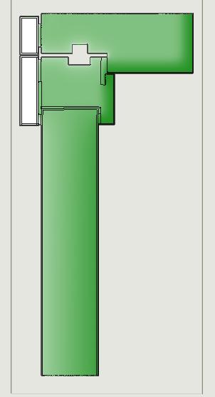

I was looking at the case with the glass included. (see picture). I was wondering how come it shows RH value in the glass but not in the outer layer? both are porosity 0.
And how come you can´t have porosity 0? Wufi gives a warning when processing saying that it may give strange results.
