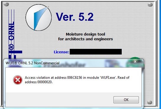

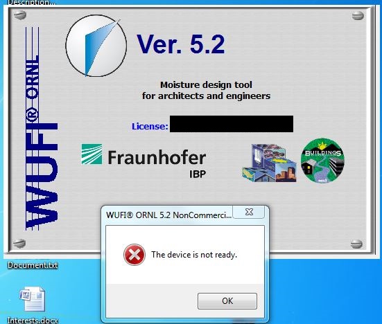

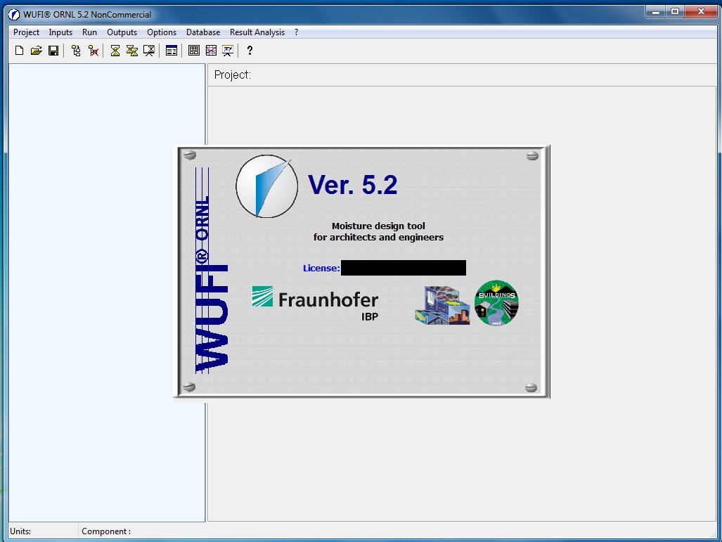

However, when I am trying to open the program 'The device is not ready' message pop up (Fig.1). Once I click Ok, 'Access violation at address xyz in module 'WUFI.exe. Read of address xyz.'' (Fig.2), click Ok again. Then, the window -- that is the same as ABOUT WUFY in HELP -- does not disappear (Fig.3). Anything I do lead to 'Access violation..' again (Fig.4).
How do I resolve this issue?
