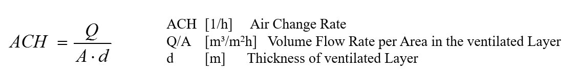

If I wanted to simulate the equivalent infiltration of outside air of a Class A assembly (q50 = 1 m3/m2h), but using the air exchange rate, how would that translated into a 1/h value?
Thank you
Posts: 352
Joined: Thu Mar 10, 2005 2:17 am -1100
Location: Northbrook, IL; USA
Re: IBP Air Infiltration Model
Post by Manfred Kehrer »
First you would need to specify what typical pressure difference to assume from outside to inside for your building enclosure. Next thing is to reduce your q50 to that pressure. Be reminded that this is typical not a linear relationship, but as you probably don't have an flow exponent, you might assume a linear relationship. Then you can calculate the ACH according to:

Manfred Kehrer wrote: Thu Aug 10, 2017 9:58 am -1100 First you would need to specify what typical pressure difference to assume from outside to inside for your building enclosure. Next thing is to reduce your q50 to that pressure. Be reminded that this is typical not a linear relationship, but as you probably don't have an flow exponent, you might assume a linear relationship. Then you can calculate the ACH according to:
Since the air change source can only be applied to the entire layer, do you recommend breaking up the layer into two separate smaller layers of the same material (one has the air change source and one doesn't)? Or do you add a 5mm air space to exchange exterior air with?
