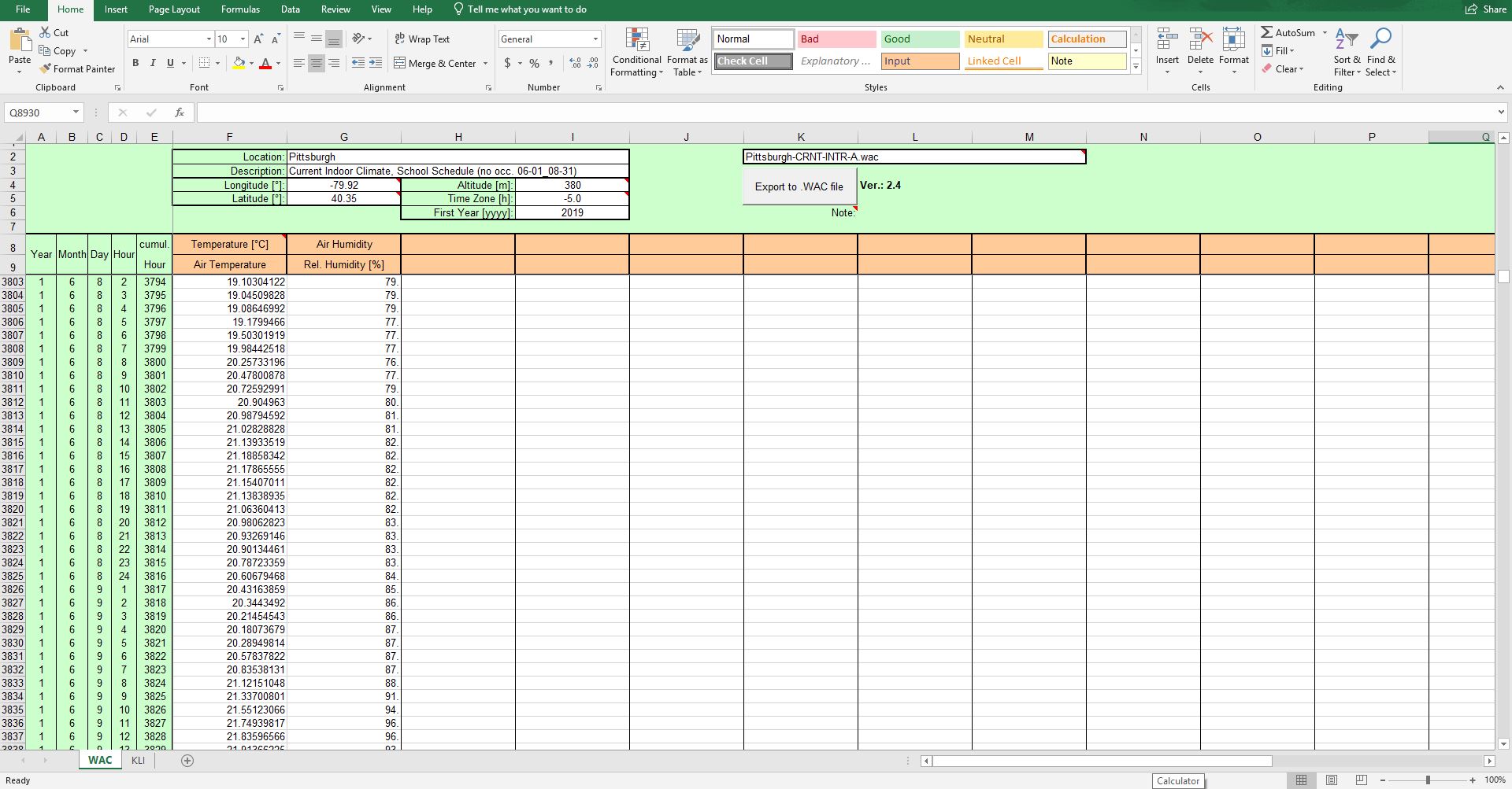

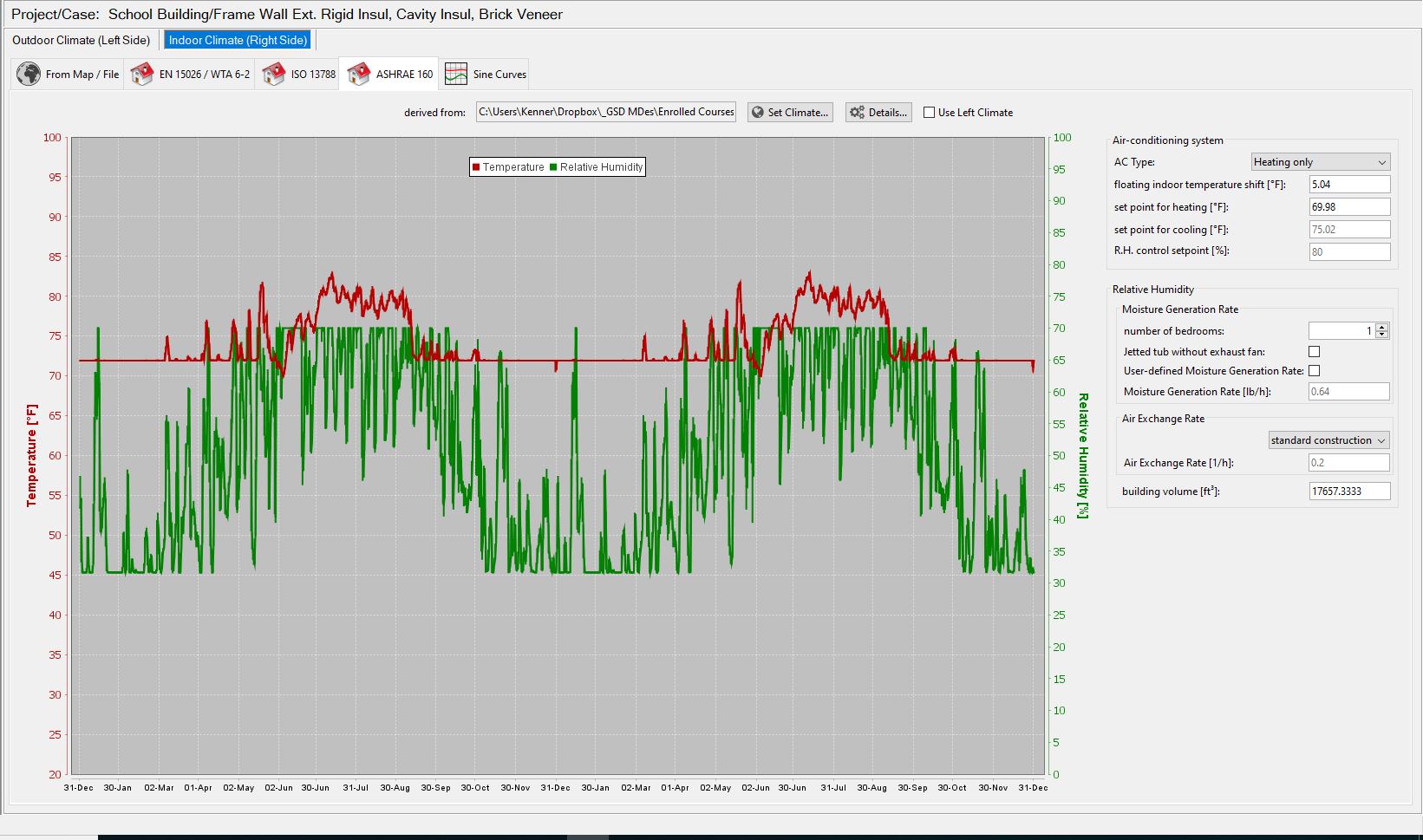

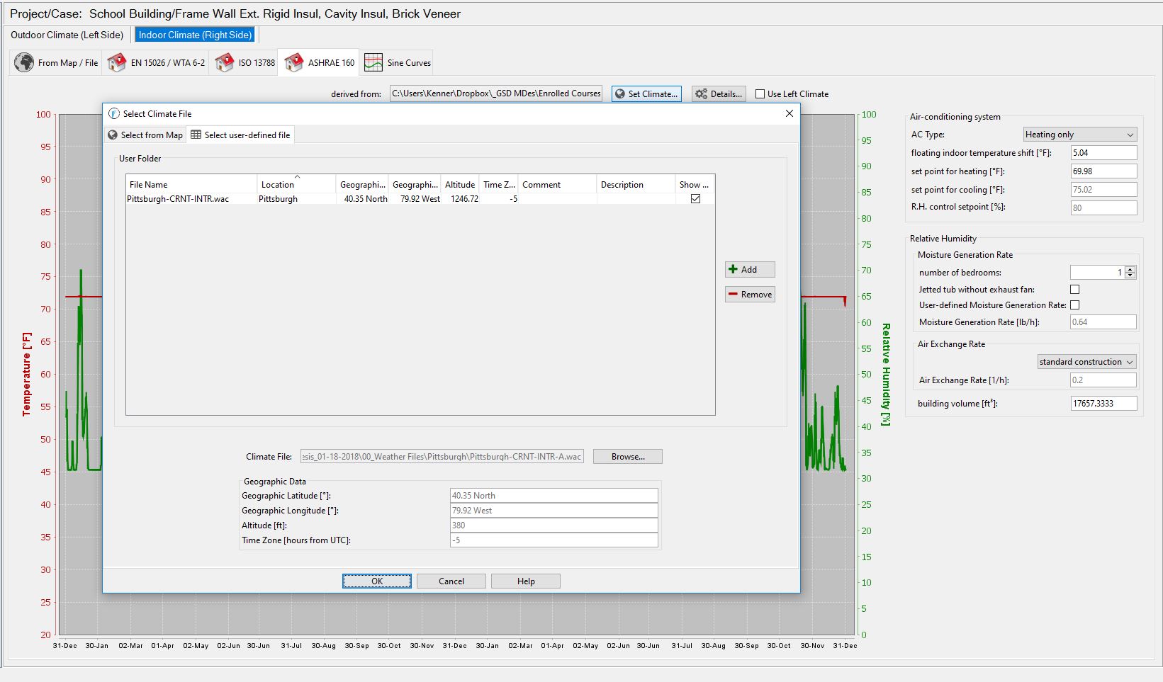

Yes, I have an educational license but I believe I have full functionality of the Pro version? I was able to generate the interior conditions I need (temperature & relative humidity) using an Energyplus model. I then used the "createclimefile.xls" tool and exported a .WAC file to define the interior climate in WUFI. It seemed to work for temperature (showing higher peaks during the summer months that correspond to the Energyplus inputs). However, relative humidity shows a constant maximum of +/- 72% for some reason. I have attached screenshots of the climatefile.xls, and WUFI visualization of the .WAC file. as a user defined interior climate.
My question is, can I represent the RH only from the .WAC output (as these are an accurate representation of the energy model)? I'm curious why there appears to be a limit on RH when I am sure the .WAC file shows RH as high as 90% during the summer months when there is no conditioning and no occupancy in the model.

Re: HVAC Schedule in WUFI
Hi Kenner,
first: you are right, the educational version has no restrictions. It can do what you want.
What you are doing wrong is the use of the ASHRAE model. If I understand you right, you like to use the wac file directly as your climate source. In this case please select "From Map/File" instead of ASHRAE 160 and open your file there.
What you are doing with the ASHRAE 160 tab is deriving the indoor conditions on the right from your wac file. There is the cut off at 72% coming from.
Chirstian
