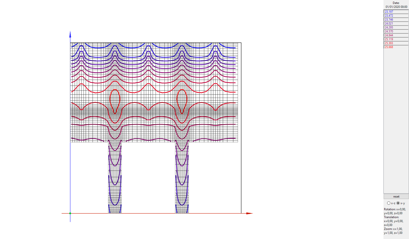

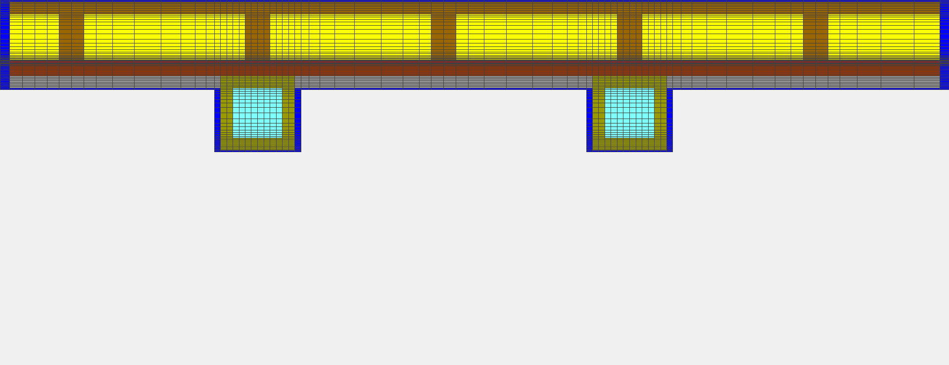

I am a new user of Wufi, and I am currently struggling to adjust my isoline graphs after the Wufi2D study.
In link of this post, you can find 2 images (structure.png which represents the normal form of my structure, and isoligne.png for the final form of the temperature isoline graph (all the isolne graphs have the same aspect)).
I would like to have the isoline graph fitting the structure form, and not a "streched" version of it. Is there any parameters to address this issue? I have tried every paramaters in the options but non of them works.
Thank you in advance for any help you can give me!

Re: Isoline graphs parameters
perhaps you should install and try VisIt.
To enable VisIt in WUFI2D just supply the correct path in WUFI2D (WUFI2D->options->settings->application->VisIt post processor) - this will add a button/shortcut to start VisIt and load your result file.
Happy post processing
Veit
