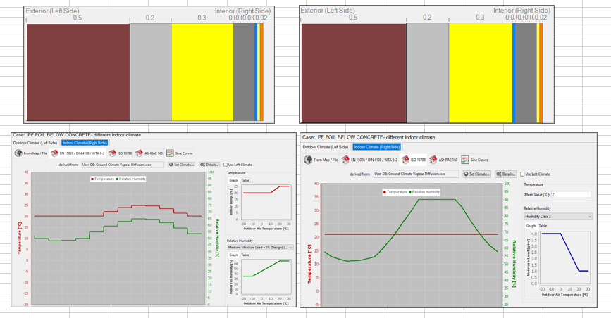

Finishing this topic and consultation- i get what you see in the images in my case
soil ("DIN" for diffusion & "FSF" for ground water/water stagnant)
gravel 200 mm
insulation (EPS, density 30kg/m3) 300 mm
Concrete 100 mm (modeled with 3 layers top middle and bottom from fraunhofer institute database)
PE foil (in one case above concret in other case below concrete)
impact insulation (ROCKWOOL)
Flooring (HARDWOOD)
two cases: PE foil above or below concrete
Interior climate two cases : iso 13788 and EN 15026 to see differences
IO VS EN.png (135.31 KiB) Viewed 118720 times
exterior climate see txt files next message
- what i get at the top of the concrete is that PE foil above concrete has higher RH than PE below concrete (75 vs 60%, dot lines) with ISO 13788 with manual calculation (using the calculation method in the center of the building below ground: L/B, d/B, vapor permeability of the materials,...).
Using WUFI and DIN soil/iso 13788 i get at the top of the concrete 75 % for PE foil below concrete but 67% for PE foil above concrete ,... see image below
Using WUFI and DIN soil/EN15026 i get 60 % at the top of the concrete for PE foil below concrete and also 60% for PE foil above concrete after 20 years but being higher until then,... see image below
1- Why is the reason of that?
ground graph.png (46.85 KiB) Viewed 118672 times
- for EN 15026, after 20 years I get same values of RH in the concrete for PE foil above or below,
2- Does it make sense?
- for ground water vs vapor diffusion I do not see any difference in RH in the concrete and slightly in the insulation (apart from the bottom of the insulation) and no difference at all with or without gravel (caìllary break) and no difference at the top concrete for diffusion, ground water + gravel and ground water + no gravel.
3- does it make sense?
4- which material do you use as a fabric filter between soil and gravel ? i saw that people use geotextil but i dont find anything similar in the database. which one do you recommend? becasue PE foil is is used as a vapor barrier or dpm in the higher parts of the ground but not between soil and gravel. Correct me if i am wrong in the concepts of the layers
these are my conclusion:
- vapor diffusion/PE foil below concrete: 300 mm EPS (vapor-tight exterior insulation) keep top of insulation dry so no moisture from soil reach the top of insulation. PE foil doen't moisture from indoors to reach the insulation so concrete ends up at the same moisture level (RH) than inddor climate
- WHEN PE foil is above concrete, RH concrete is below than with PE foil above concrete because no moisture from indoor reach the concrete and no moisture from soil reach concrete due to 300 mm EPS
- EN 15026 get lower RH in insulation and concrete due to lower RH indoors vs ISO13778 Humidity class 2 (+4 g/m3). See graphs from inddor climate in WUFI. RH indoor reach a peak of 90% (75% average) for ISO 13788 while EN 15026 (maximum 65%) meaning unrealisting moisture for indoor climate in a building.
- Manual and WUFI calculation for vapor diffusion - PE foil below concrete and ISO 13778 Humidity class 2 (+4 g/m3) get the same RH at the top of the concrete (around 75%) and this value is below the RH critical for concrete, 85%.
- Manual and WUFI results (RH at top of concrete) contradict each other when PE foil is installed above concrete.
- EN 15026: The presence of ground water does not have impact in the RH of the concrete maybe due to 300 mm EPS (EPS:close-cell insulation so it is resistant to water and moisture. This means that it does not absorb them) because non-existent layer of gravel (capillary break) have hardly an influence in the result regarding to RH in the concrete although in the reality it has.
5- How can WUFI take into account the effect of gravel as a capillary preak?
Let me know if i am right and make my conclusion sense in general
thanks in avnce and apologise for all this
