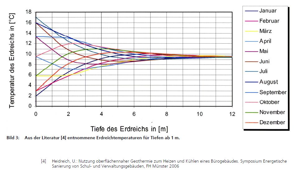

if I calculate a construction in the ground I use temperatures from literature, for example this one: From that I generate a sine-curve for the temperature.
You probably have to find something what is corresponding with your location.
For the relative humidity i set constant 99 or 100% as we assume that otherwise nothing will grow.
The catch the influence of the temperature exchange between the construction and the soil I build a layer of soil on the outside of the construction, thickness about 0.5m.

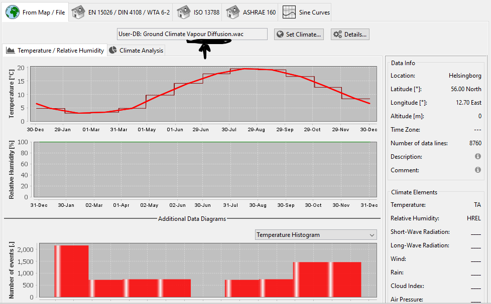

1- Any chance to get these temperature values from the graph in an excel or txt file?

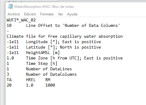

2- then if I have understood correctly the "mateiral information" in wufi database about the two types of soils that you added, the weather climate associated to each one are:
2.1 for the case Soil 'Christian' FSP , the weather file .wac should contain three parameters TEMPERATURE (graph above for example), RH (constant 100%) and RN =1000
2.2 for the case Soil 'Christian' DIN , the weather file .wac (outdoor climate-blue line image) should contain only two parameters TEMPERATURE (graph above for example) and RH (constant 100%)
3 see photo attached. Should I place the .wac file for ground there (blue vertical line)?
4 what don't I understand is how the lines below are defined in the .wac file? Do they correspond for west and south orientation? where do those numbers (-1e11) come from or what do they mean?
-1e11 Longitude [°]; East is positive
-1e11 Latitude [°]; North is positive
-1e11 HeightAMSL [m]
5 I guess that the temperature value is quite high (20 degrees see screenshot above) for a soil and I should put the value(s) from your graph or the right one for the soil in my location (variable for the whole year or constant value depending if I have data available). Am I right?

Position and Height is only needed, if radiation has to be transformed to other values. So for soil these values are not necessary.
I do not have them, but I also do not need them. You can easily create a user-defined sine curve in WUFI indoor climate from the max and min value for the needed depth. For example in 4m you can use 7.5 °C (blue, April) as min and 11.5 °C (pink, Oct) as max. You can create the sine from that with the following parameters: mean value 9.5 °C and amplitude 2K. To add this in a climate file, you can calculate for one year and export the curve.1- Any chance to get these temperature values from the graph in an excel or txt file?
yes, right, Soil Christian FSP can be used with liquid water, the DIN one only takes in account moisture transport by diffusion.2.1 for the case Soil 'Christian' FSP , the weather file .wac should contain three parameters TEMPERATURE (graph above for example), RH (constant 100%) and RN =1000
yes, right. Further use "Basement" as setting for heat transfer coefficient.3 see photo attached. Should I place the .wac file for ground there (blue vertical line)?
-1e11 means, that no value is given here. A numerical value is necessary here. That is used instead of 0, as 0 would be a valid input.4 what don't I understand is how the lines below are defined in the .wac file? Do they correspond for west and south orientation? where do those numbers (-1e11) come from or what do they mean?

yes, right5 I guess that the temperature value is quite high (20 degrees see screenshot above) for a soil and I should put the value(s) from your graph or the right one for the soil in my location (variable for the whole year or constant value depending if I have data available). Am I right?

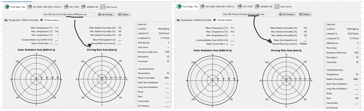

- what i get at the top of the concrete is that PE foil above concrete has higher RH than PE below concrete (75 vs 60%, dot lines) with ISO 13788 with manual calculation (using the calculation method in the center of the building below ground: L/B, d/B, vapor permeability of the materials,...).
Using WUFI and DIN soil/iso 13788 i get at the top of the concrete 75 % for PE foil below concrete but 67% for PE foil above concrete ,... see image below
Using WUFI and DIN soil/EN15026 i get 60 % at the top of the concrete for PE foil below concrete and also 60% for PE foil above concrete after 20 years but being higher until then,... see image below
1- Why is the reason of that?
- for EN 15026, after 20 years I get same values of RH in the concrete for PE foil above or below,
2- Does it make sense?
- for ground water vs vapor diffusion I do not see any difference in RH in the concrete and slightly in the insulation (apart from the bottom of the insulation) and no difference at all with or without gravel (caìllary break) and no difference at the top concrete for diffusion, ground water + gravel and ground water + no gravel.
3- does it make sense?
