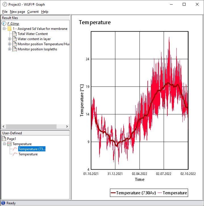

Can someone explain how to calculate and graph the 30 day running average RH for a given layer? I have seen images of this analysis from WUFI, and it is referenced in ASHRAE 160 section 6.2 - however I cannot find how to calculate this in WUFI Pro.

here you can find a explanation of the moving average:
https://en.wikipedia.org/wiki/Moving_average
You can create courses in WUFIGraph: The window size is related to the time step. In this case the results contain hourly values, so 730 hours corresponds to one month => Monthly average.
This is how it looks result: Christian
