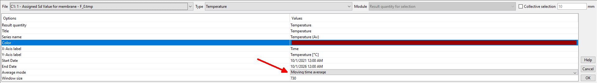

You can create courses in WUFIGraph: The window size is related to the time step. In this case the results contain hourly values, so 730 hours corresponds to one month => Monthly average.
This is how it looks result: Christian
