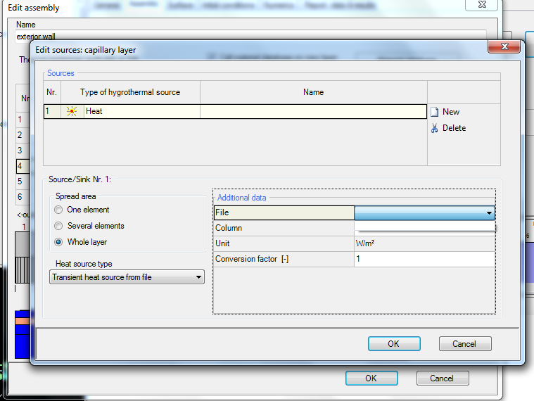

Hi Christian,
maybe I need a different approach. I just created my own layer embedded in aerated concrete. Now I want to add a heat source for the whole layer (the whole layer should have a temperature of 20°C). Therefore I need to upload a file. How can I upload or create this file? I attached the screenshot for you to see.
Thank you very much for your help!

Philip,
The only way to create a heat source which keeps your layer at a constant temperature is:
1) perfom a calculation with a source
2) export the average temperature of your layer.
3) calculate externally the source/sink on an hourly bases you need to keep your desired temperature
4) recalculate within WUFI
Iterate steps 2) to 4) until your source file does not change anymore which should be at the point where your layer has the desired temperature

Hi Manfred,
thanks for your answer!
Could you explain me, how I can perform step 2) "export the average temperature of your layer" ?
Or should I just take the average temperature calculated by WUFI to calculate my heat source externally? But then how does the recalculation (Step4)) work....eventually I need to import an external file to the software, right?
best regards and thanks for your help!
Philip

Post by Manfred Kehrer »
If you have an insulation somewhere, most likely there is not a big temp gradient within the air layer, so just use the temperature in the middle.
Yes import from file!

Thanks for the quick reply!
What kind of file can be imported in WUFI?
Posts: 352
Joined: Thu Mar 10, 2005 2:17 am -1100
Location: Northbrook, IL; USA
Re: heat source within the wall
Simple,
1st column time [h], 2nd heat source [w/m2]
Tab or space separated.
