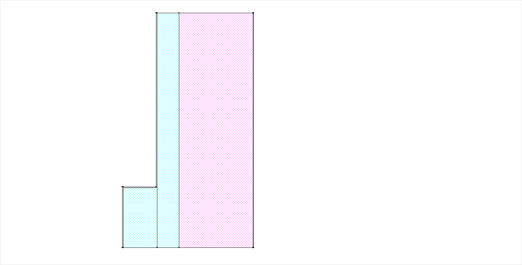

Hi WUFI team,
Please help, I am desperate. Below is the geometry representing a ventilated roof. I have metal decks on both sides of the roof. For the cavity (in light blue), a 250 ACH air change source was applied. The pink part is the PIR board and liquid distribution coefficients were applied to it.

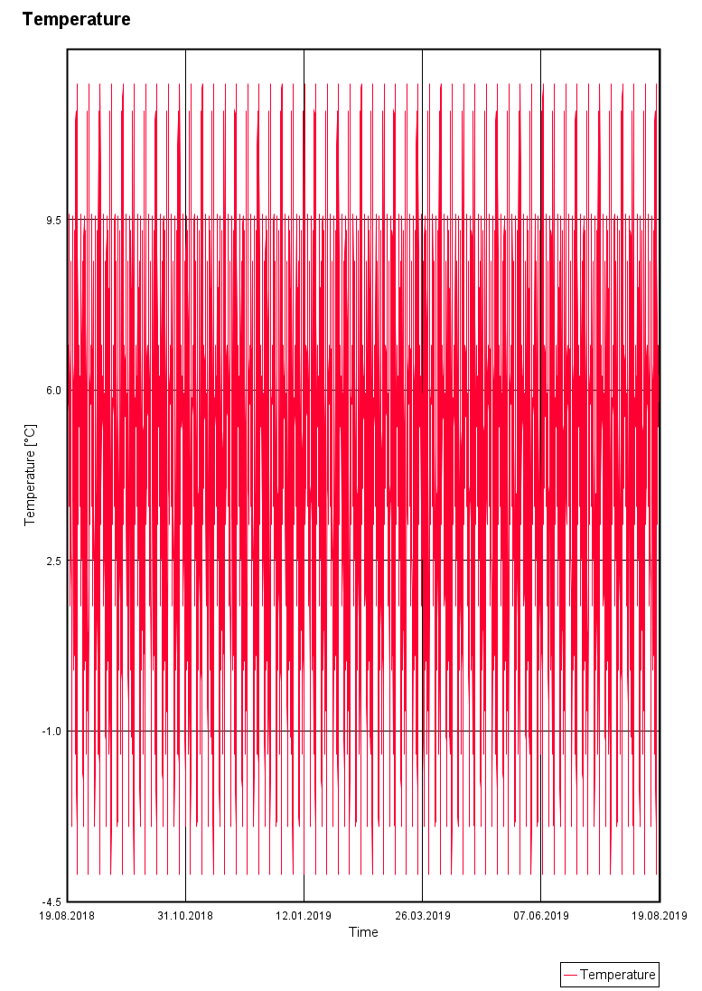

The temperature of the outermost metal deck:
temperature of outermost.png (144.3 KiB) Viewed 56292 times

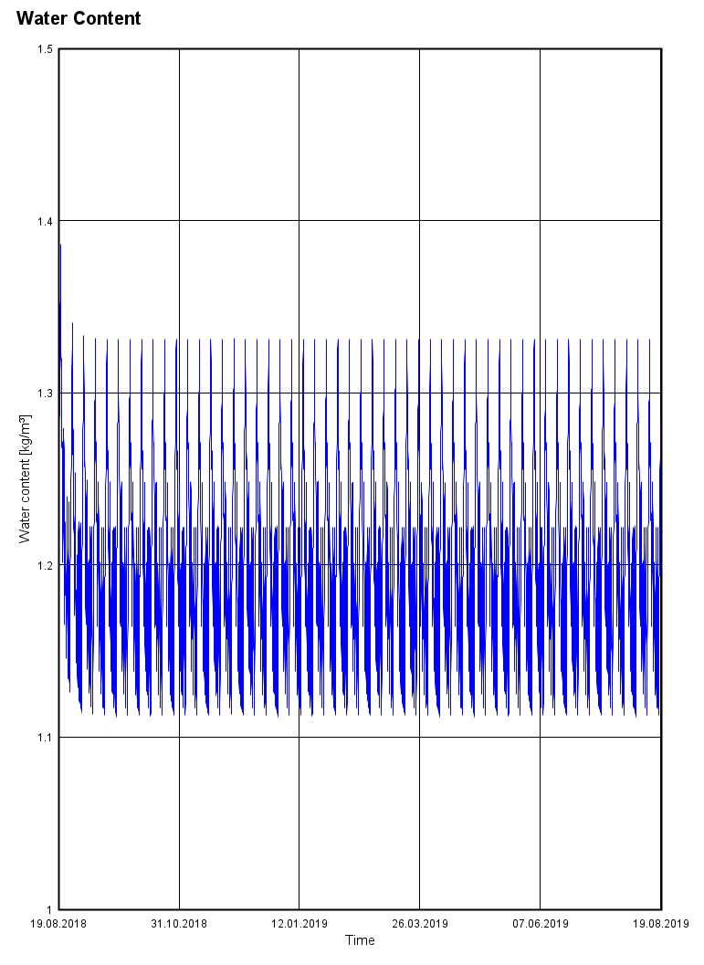

Water content of the PIR board:
At least I would expect that the temperature would vary with the season, but not.
I do not think the settings are the problem cause they are almost all by default, except for the explicit radiation is turned on.
Could anybody please help me? thank you!

I highly suspect it was a numerical issue.
Any clues? Thanks!!
Posts: 430
Re: Unexpected water content and temperature in WUFI 2D
Hi WEI LI,
this may be a bug causing a wrong time step size. Please see here for a solution: Wrong timestep in climate file.
