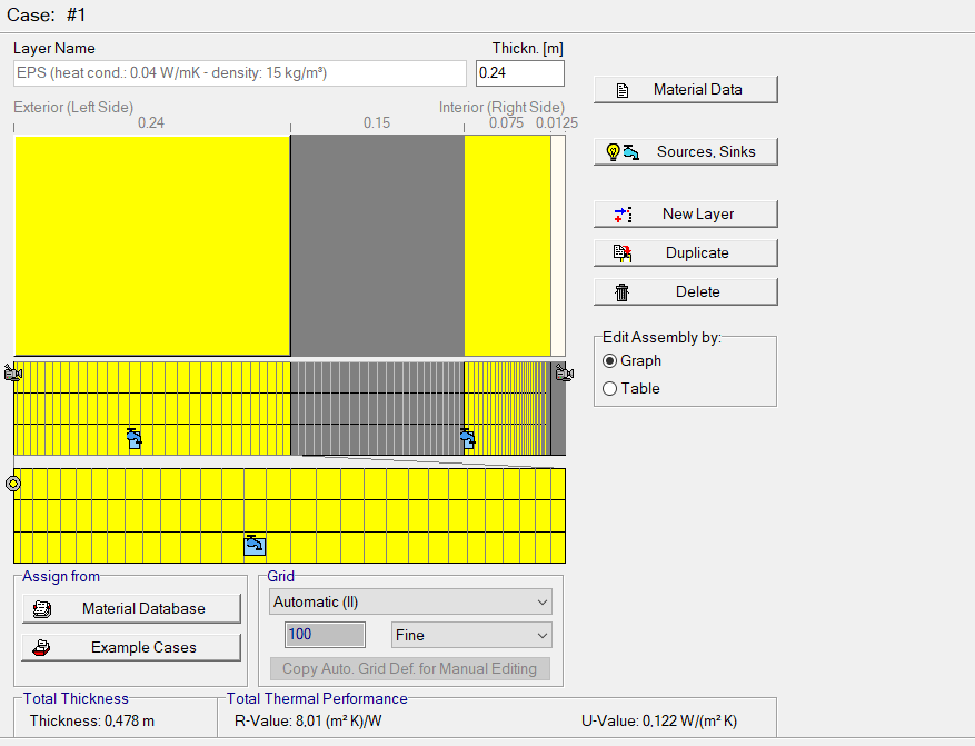

I am trying to simulate a ICF wall in WUFI pro but i am unsure about the assumptions I established:
ICF WUFI PRO.png (33.38 KiB) Viewed 53871 times
the wall is:
Acrylic stucco (I defined the stucco as an external sd-value in the tab "surface transfer coeff" )
EPS 240 mm
Concrete 150 mm
EPS 75 mm
Gypsum12.5 mm
QUESTION 1: does the layers typical for this type of construction?
I modelled two moisture source.
the first one simulation a crack in the window sill representing a rain leakage (1%) ,
QUESTION 2: is it right to do in this way and in the position I did it?
the second one, behind the concrete representing a infiltration leakage (0.6 m3/m2h) because it is more vapor resistant (higher mu-value) than the EPS so it is trapped in that position,
QUESTION 3: Is it again right this asumption?
QUESTION 4: is the acrylic stucco used in ICF systems as an external layer? do you recommend other material?
QUESTION 5; Do i put the "adhering fraction of rain" equal to 0?

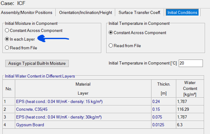

in regards to initial moisture content,
QUESTION 6: is it right to consider this initial values clicking the option "in each layer"? the concrete ones is the most critical an it is equivalent to 95% RH

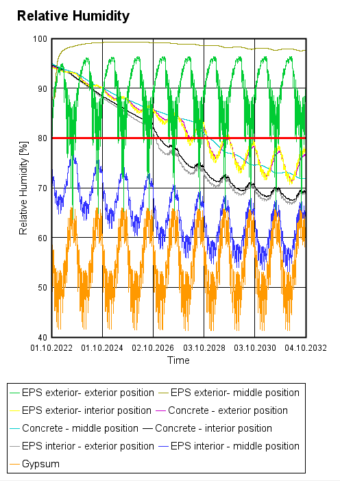

this is the results (I hope it is clear each case/position)
Captura de pantalla 2022-10-30 114629.png (30.41 KiB) Viewed 53871 times
QUESTION 7: Is a problem to have such amount of RH in the external EPS of the ICF wall? what problems can caused apart from lower energy performance?

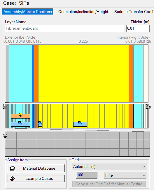

i forgot to add the next comment for a SIPs system,
QUESTION 9: does it make sense to define the rain leakage in the middle of the insulation due to window poor workmanship but the infiltraation in the cold side of the insulation?
