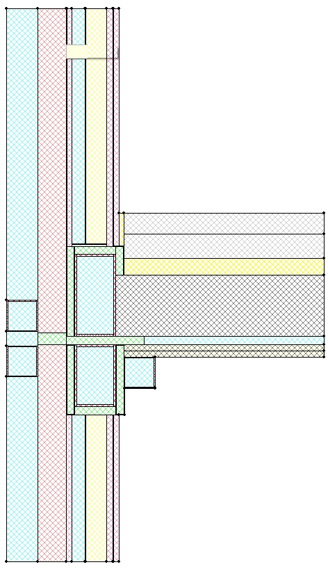

I am trying to simulate a steel structure modular house junction.
I modeled as below, and I haven't put in the source yet.

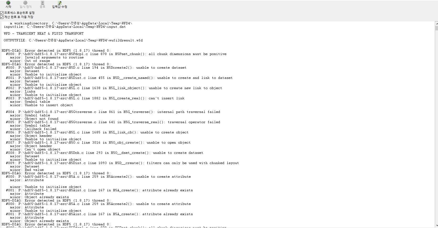

An error occurred in the calculation result, and the result is unknown.
What is the cause of the error?
*.wfd simulation result file was not created.
** Questions
1) What is the cause of the error?

HDF5-DIAG : Error detected in HDF5 (1.8.17) thread 0

Hi eunseop ahn,
your construction is to big for the grid setting, so the grid can not be fully build. There is a little red error message in your grid window, you should not ignore. Please try to increase the maximum grid elements from 150 to 300.
Further you build a detail with a very high grade of details. You should think about simplifying your construction.
