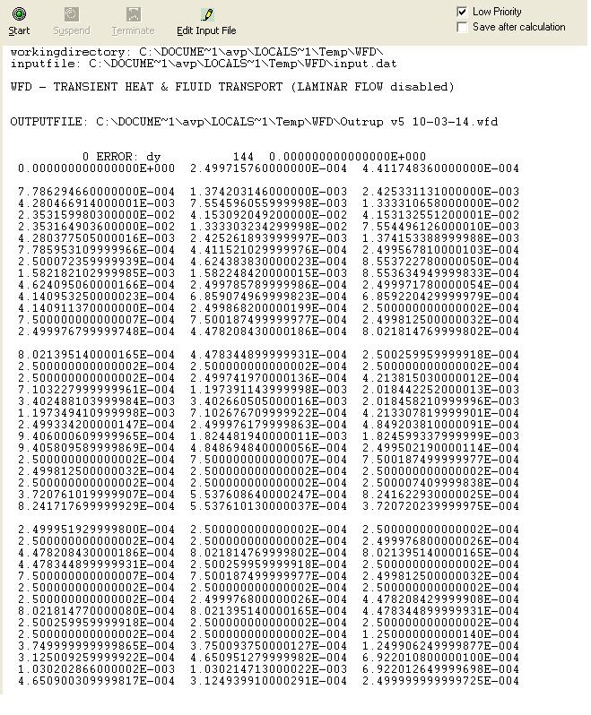

Im having troubles processing my file. It takes just one second for it to finish and it doesn´t give me any error messages, all it displays is this image:

This means at least one of your grid-volumes has height of zero (dy=0.00).
You need to check your geometry and grid. Most likely there are rectangles having different x-coordinates intended to start/end at same y-coordinates. But the y-coordinates are not exactly the same.

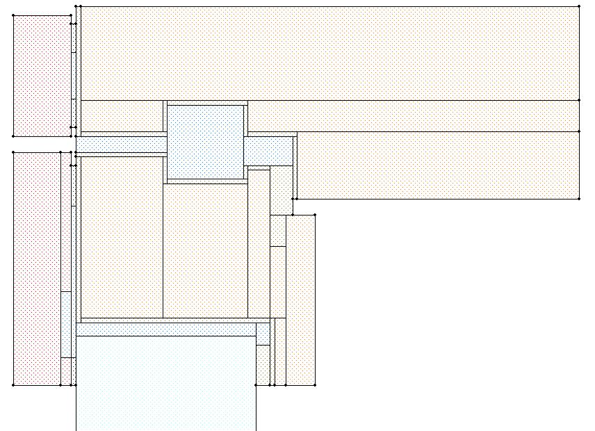

Hmm.. got the same problem again and can´t figure out how to solve this problem. I have gone through the geometry and everything seems to fit perfectly - so it has to do with the grid settings?

Could you post your geometry (copy/paste the content of the geometry editor)?

veitner wrote:Could you post your geometry (copy/paste the content of the geometry editor)?
sure
Heres my geometry code:

veitner
Posts: 135
Re: Problems with processing
Post by veitner »
Wow - never thought about such complicated geometries!
I guess the problems are caused by the 1/1000 mm. Usually we limit our layers to 1mm.
Would it be possible to redefine your construction to avoid fractions of mm?

veitner wrote:Wow - never thought about such complicated geometries!
it is a crosssection of a window so it can be easily become complicated :)
okay so it is because some of my lengths are fx 20.225? so perhaps i should try to make it in integer mm.
