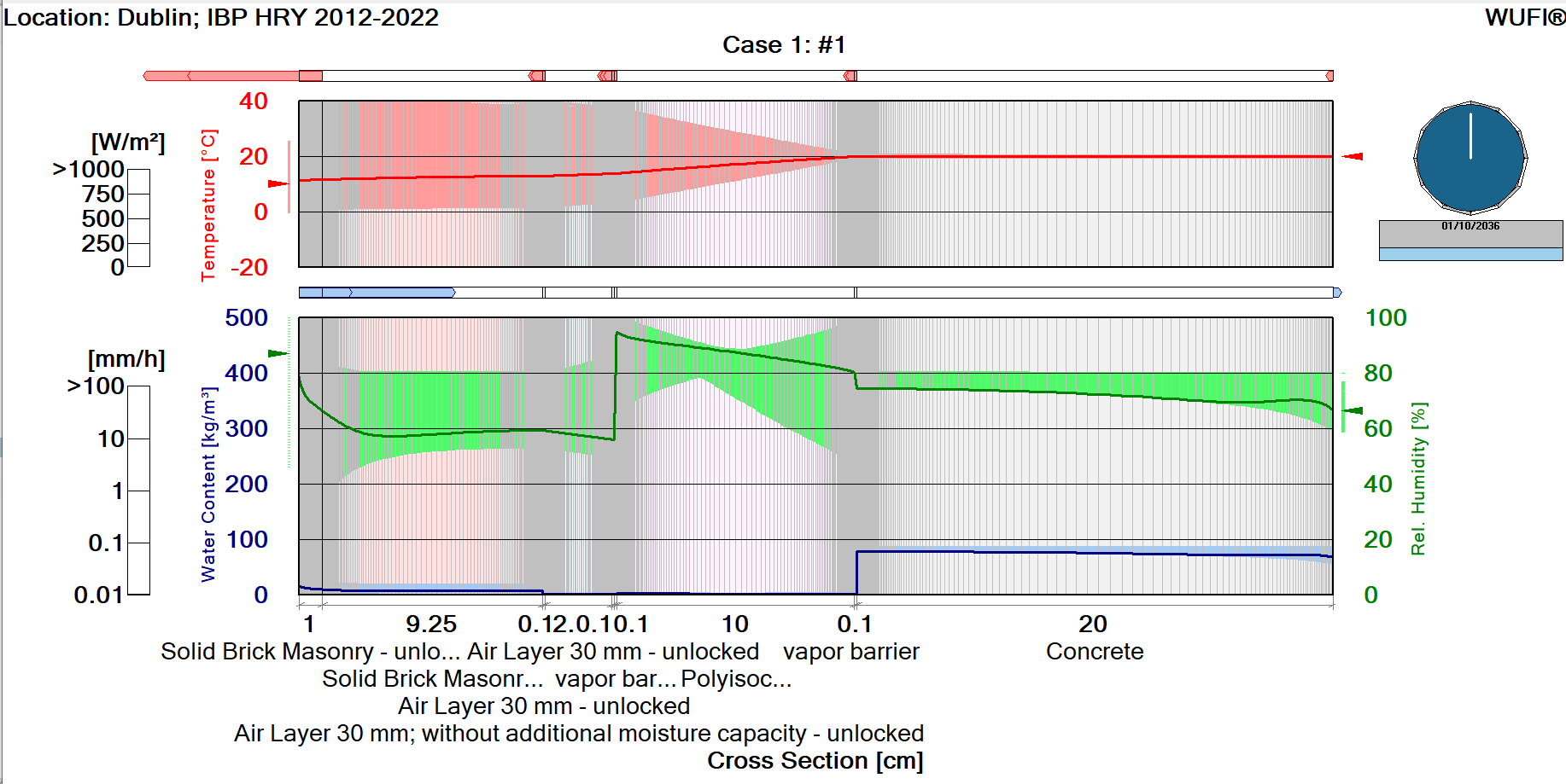

I have the next build-up with water repellent and foil faced PIR in both sides modelled as vapor retarder (sd=1500).
is it right?
Evaluating the WC in the PIR I have observed irregular, non-periodic changes in the total water content what makes me think that something can be wrong in the results. any thoughts about this change in trend?

Dear Alberto,
you're right, that does not look very good.
The steep vertical increases in water content are obviously not correct. However, in the total balances these problem remain unvisible - this may be because the issue is simply a slightly incorrect distribution of moisture within the building component, which is not apparent either in the total water content or in the surface moisture fluxes.
In any case, you can assume that no moisture accumulation will occur between two layers with an sd value of 1500 m. And ss the total error ist only 0,01 kg or 10 g (0,1 kg/m³ * 0,1 m³) over 10 years, the influence on the neighbour materials remains completely negligable.
In other words, to sum up: You can perform a normal evaluation.

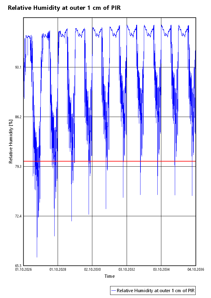

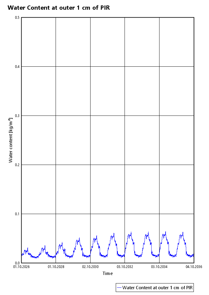

Water content at outer 1cm of PIR.png (20.18 KiB) Viewed 44588 times
RH at outer 1cm of PIR.png (25.73 KiB) Viewed 44588 times

I was talking about that water that forms between surfaces...mainly between vapor retarder and PIR as the RH is above 95% (see image RH outer 1cmm of PIR) but wáter content keeps stable...any thoughts?
How can you detect based on WUFI result when condensation/run off will occur between surfaces and when condensation will occur inside the close cell ínsula (PIR) pores?
In the image above, the difference in water content in PIR over 10 years is around 25g (above ± 10 - 20 g/year) in the PIR, is It a concern? You mentioned above that that ± 10 - 20 g/year is not...

The moisture shown in your results is located within the PIR, which is enclosed by vapour-tight aluminium facings on both sides. In a one-dimensional calculation, practically no additional moisture can enter this layer. The variations therefore mainly represent a redistribution of the initial moisture within the PIR caused by the changing temperature gradient.
You can either disregard this redistribution as unproblematic or check whether the assumed initial moisture content is too high, since PIR is likely to be installed with a considerably lower initial moisture content than that corresponding to 80% RH.
Any runoff assessment would refer to the air layer adjacent to the outer aluminium facing, not to the interface between the PIR core and its factory-applied facing. Under typical climatic boundary conditions, no problematic condensation is expected on the outer side of the facing in this configuration.
